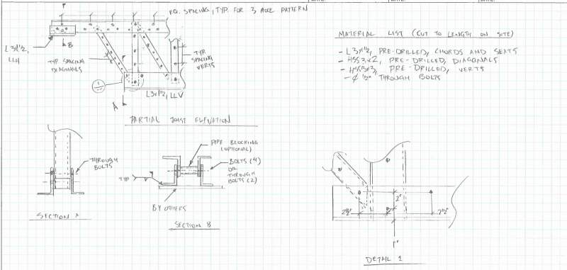

Advantages & generally clever aspects:
1) Only two steel cross sections used. Just order a bunch of angle and channel and go to town.
2) End product is basically a KCS / constant shear joist good for RTU's etc if necessary.
3) Vertical webs should make the thing easy to jig up on an assembly table.
4) Optional end block should be able to generate almost limitless rollover capacity (finally).
5) Joists should be decent for nesting / stacking on a truck.
6) Critical compression chord diagonals come together with the centroids well aligned.
7) Less critical tension chord diagonals are eccentric but:
a) the tension will tend to straighten them out and;
b) the verticals should help rectify this via relatively stiff, weak axis flexure.
8) Conventional deck attachment to double angle chords.
9) Simple, automatic spacing of chords during fabrication.
10) Clean look for exposed applications.
11) Flat faces of vertical channel webs will be easy to fasten bridging or strong backs to.
12) I'll think of something to make it an even dozen...
