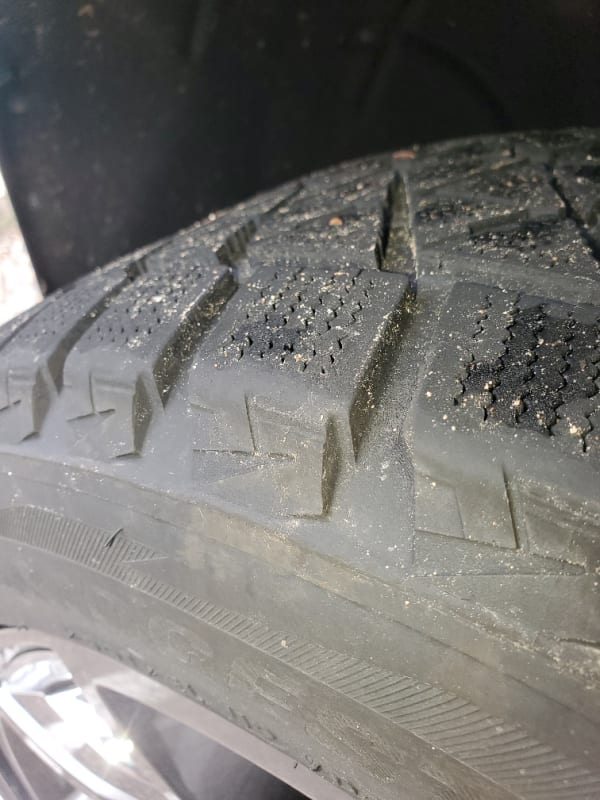

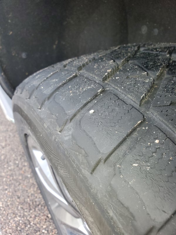

Some pictures:
Front left tire
Rear left tire
Tire shop did alignment when installing the new tires (they insisted since the new tires were so soft). Tires are Michelin Blizzak. Total mileage on 2015 Tahoe is 34,000 - maybe 20,000 on the originals and 14,000 on these. One of the originals actually wore down to threads in one spot.
Tires are rotated so the worn "fronts" are now on the "rear".

Your image suggests perhaps toed-in a bit. Possibly some camber compliance and - as you said - driven pretty hard. A good wheel alignment guy could customise the settings a little to better suit your driving style if that is the problem. Less camber, less toe-in, more caster, more tyre pressure.
More tyre pressure is an easy place to start. That will probably improve everything except ride quality.

Check the alignment, it's likely off. I was thinking toe out causes outside wear and toe in causes inside wear. At any rate, toe will wear a tire quicker than anything else because toe makes the tire have to slide sideways slightly even when going straight.
See that the numbers are good, not just within the spec range. Sometimes, the machine has a window as wide as the ideal alignment number. I generally say a bit of negative camber and a little toe in works. Caster can be up to as much as you can get, possibly a little more on the passenger side to help with road crown.

Some of these vehicles can suffer from worn suspension bushings. You can realign it on the rack and on the road it won't be the same. I've had a couple and struggled with sawtooth wear on the outer tread blocks more than I expected.
I'd take it to an alignment shop and ask for a custom alignment with more negative camber. The justification is right there in the tread.
