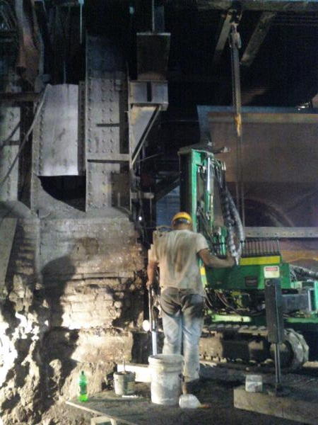

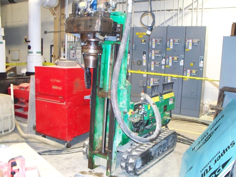

Thanks jayrod. I've used cased micropiles for other structures at this facility, but in those cases I had more headroom and space to work with and the drilling rig was about the size of a typical excavator. With this CNC machine, I will be in tight quarters and low headroom near another existing CNC machine that is in daily use. So I'm looking for a solution that can use smaller equipment with less disturbance.

I monitored micro-pile installation with a low clearance rig. It would fit through a single man-(person) door. The mast was only about 6 to 8 feet tall.
