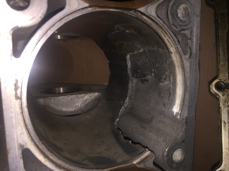

Which direction do the cracks run, longitudinally or circumferentially? Longitudinal cracks I would suspect to be pressure related, circumferential cracks may be temperature related.
They are all longitudinal. They all also happen intermediate of the structural support to the block deck, at the top of the sleeve.

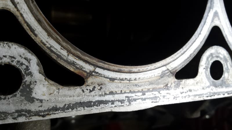

Not my pictures but this is what we are talking about. Almost all of the ones I have seen (online or in person), the crack is at the top of the sleeve, just inside the support. To me, it looks like the vibration builds up stress there, more than anything. The lack of "support" just abuses the modulus of the material and it cracks I believe.
Next the two casting materials should be the same; 319 t5
The second pic is what's really interesting; the crack has broken the aluminum casting but not the spun cast iron, yet. Which to me is even more evidence that this is a vibrational issue.
