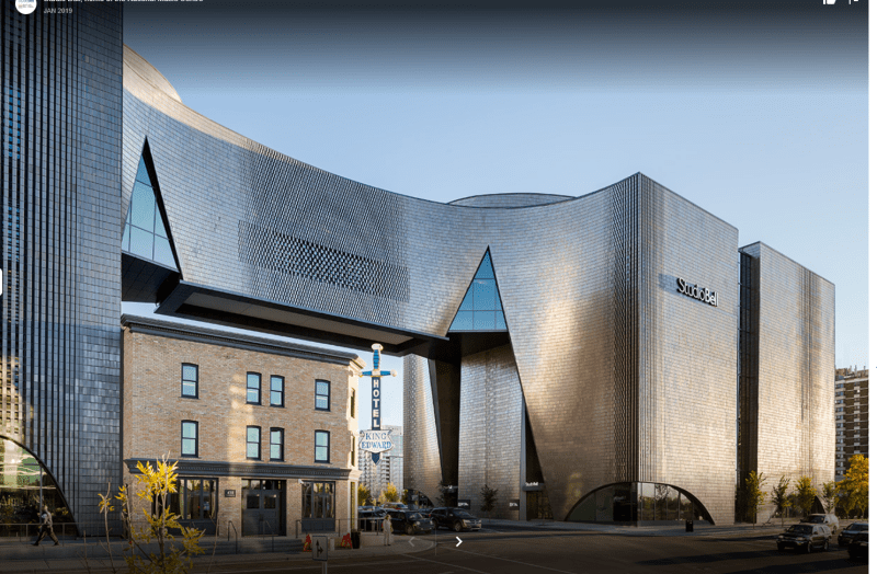

I dealt with similar issues on the building below and found it to be rich with complexity regarding constructability, thermal movements, and lateral design. I'd be happy to attempt to help with this but I would need to know quite a bit more about the details of your situation. Can you post:
1) A basic building elevation perpendicular to the bridge(s).
2) Your understanding of the boundary conditions of the bridges at each end?
For conventional connector bridge detailing, it can be quite difficult to avoid the lateral / torsional coupling issue shown below. In my case, we wound up abandoning the bridge movement joints entirely for this reason and, instead, rigidly connecting the two buildings across the bridges. But, then, our bridges were about half as wide in plan as the buildings themselves which facilitated this. With a bridge skinny relative to it's floor plan width, a different solution would likely be required. A single, central pivot point on the fixed end might be neat.
