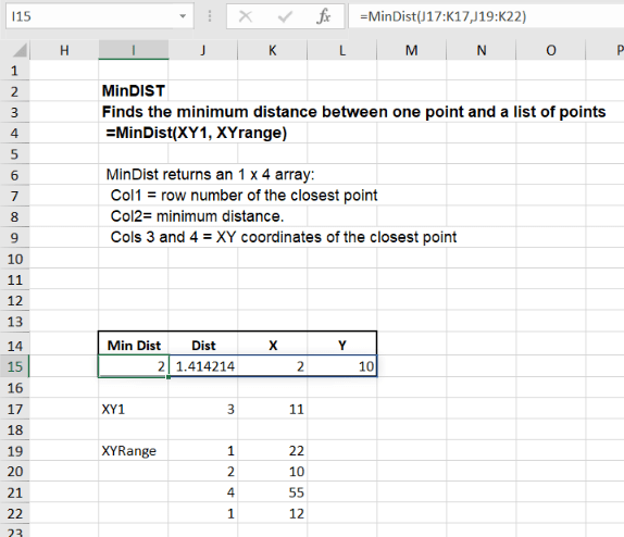

Could someone please help how to find using VBA the nearest value between coordinates from array2 .
Example :
array1
X Y
3, 11
array2
X Y
1, 22
2, 10
4, 55
1, 12
In this case to return -> 2,10
Thank you !
My IP2 spreadsheet already had a maxdist function, so I modified it to a MinDist function:
(I also plotted XYRange with a red line, but I used transparent ink)

You can download the spreadsheet (with numerous functions for line intersections and related tasks) from:
more-updates-to-arcspline-and-ip2
