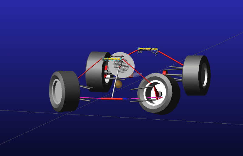

For the past few months I've been trying to implement our Formula Student suspension into Adams Car FSAE template. Our formula car has so called decoupled suspension, so i had to make my own templates for front and rear suspension and ARB. My assemby behaves very weirdly and I cannot pin-point the problem.
For example:
I ran an accleration test. At the second increment simulation stops. To exaggerate the problem, I have increased the error number and number of steps. Result of the acceleration is shown on the pictures below. Car accelerates and the suddenly turns. Car has the tendency to steer (don't know if steering is the problem) into one direction.
When I tried to simulate hand free test, car drives foward with slowly turning to the right. I am attaching link to adm and msg files of the acceleration test I ran:
Has anyone seen anything like that before? I am really desperate to finish this project.
Please help!
Sorry, I can't get onto that download site, use the the engineering.com upload instead. However the disgraceful format of the /Car adms means I won't learn much.
So, in a straight line acceleration the steering controller will probably be set to 0 SWA, so your acf/xml files might be more useful.
SLA (if that is what you've run) is a weird event, it is a static equilibrium at each acceleration increment. I'd start with straight line drive. Anyway, I think you'll find the steering controller isn't correctly linked to the steering wheel.

So, I am using a steering template that is psrt of the FSAE templates that you can find on the internet. I have only changed hardpoints, so I don't think there should be any issues regarding the steering? Or?
I have ran a Straight-Line Drive instead. The result was basically the same, only that the wheels were turned in different direction. I have noticed that the wheels behave very weirdly and tend to loose contact with the ground. Could the problem be here? (picture below)

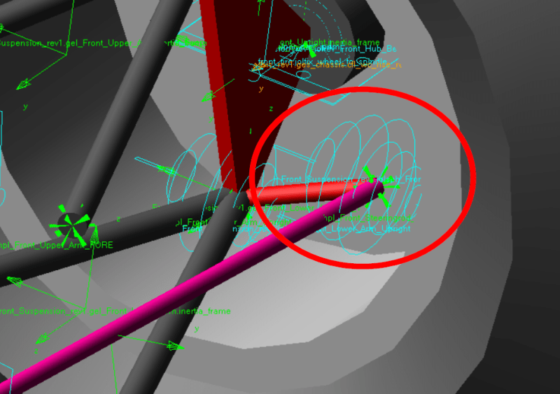

I've had seen that the Adams is unable to satisfy the constraint for: SphJnt/30. However I was hoping that there is some additional info in the log files that implies error in the steering / suspension. SphJnt 30 is actually a balljoint between steeringrod and upright (picture below), which is realistic.
Can you tell me, which constraint should be between steeringrod and steering rack? Currently i have hooke. Could this be a problem?
