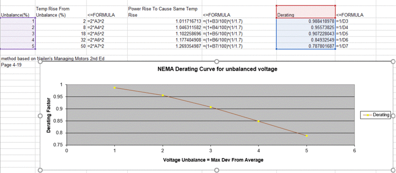

I have looked at the derating curves for operation with unbalanced current. You can work out the math of how they come up with the curve (below) but the logic behind that math is a little fuzzy to me at the moment. I think I'm not sure if it's empirical or theoretical or perhaps a combination (empircal parameters plugged into theoretical model).
That was a little bit of rambling to explore the subject in general. But to focus back on op, those derating curves based on voltage unbalance (typically current unbalance can be 5-10x more). Op has both voltage and current balance readings and there is certainly no derating indicated for his numbers.
