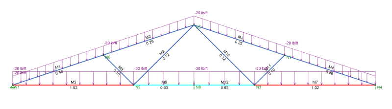

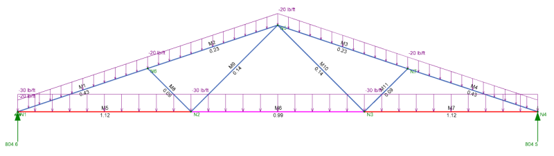

I am working on a project, a residential remodel, where the clients would like to remove an interior wall which is located directly under the middle of the existing roof trusses. This mid-point is about as far from a panel point as it can be. The bottom chord appears to be 3 equal spans. They are 2x4. During the home inspection I noticed the trusses were stamped with the word "Hemlock." However, I did not see a grade indication. Now I am attempting to perform the analysis in RISA and Hemlock is not one of the available choices where the 2x4 or 2x6 sections can be applied in the program, nor can I use a custom rectangular section with Hemlock in RISA. Also, I was not able to find Western Hemlock in the 2015 NDS Supplement. I can select Hem-Fir, in RISA, which I think should have similar mechanical properties. Is that correct? How do the mechanical properties of Western Hemlock compare to those for Hem-Fir? Secondly, using Hem-Fir grade 1, the existing trusses appear to be overstressed at the bottom chords by about 2%. When the support is removed, the overstress is about 12%. But, when I use structural select grade, there is no overstress in either scenario. Is it safe to assume structural select was used originally as grade 1 looks overstressed? Or is grade 1 more likely? Have wood design rules become less demanding or more demanding over the years? The house was built in the late 60's. Any assistance you could provide would be greatly appreciated.

Pham, I appreciate your thorough response. I will post the question in the general forum. I am attaching some model graphics as well. Spacing is 24" O.C.. combo 4 has 10psf Roof DL, 5psf Ceiling DL, and 10 psf Ceiling LL. All wood is specified Hem-Fir #1, in these models.

As-built:
Wall Removed:
Hmm...did you model those as individual members between nodes? What about end releases? It looks like all your web members are fixed?
These trusses aren't the nice, simple things from a statics textbook. The Metal Plate Connected Truss industry takes advantage of all sorts of stuff to eek out every last bit of economy that they can from these things.
- Heel Joints are modeled with at least partial fixity
- Top and Bottom Chord members are typically continuous across joints with web members which allows them to contribute flexural stiffness to the joints
- Some other joints, depending on demand and size of plate, can be considered to have partial fixity as well
So make sure, at the very least, that you have placed the joints in your chords in the right places.
Good point, you might want to look at the moment diagrams. You don't want to see moments at the ends of any of your chords or web members. Internal moment along a chord, that's okay, of course. At least that's my assumption for any truss that gets my stamp.
Granted, the big time truss manufacturers have some assumptions about how those connection plates affect rotational connectivity. But, I don't generally play with that. If I'm re-working a truss like this that doesn't work as is, then it's not usually all that difficult to double up a chord that is failing.

The chords are continuous across the joints, including at the node I placed for the support in the middle of the bottom chord. The webs are pinned at the ends. I did not consider any rotational stiffness from the webs. I could possibly take a look at that.
The full span is 31.5'. 10.5' between panel points at the bottom chord.
I didn't check for a gap. I assumed the top plate of the wall was nailed to the bottom chord of the joists. It has drywall on al sides right now.
The foundation is a slab. So, no indication from that either.

It looks like overall, the joist would not collapse. The top chords are well below unity for all load combinations. The only thing I would worry about, after seeing this, is if somebody were to apply a big load on a single bottom chord out there where it shows overstress. Like by jumping on it. But, the wall would not help in that case anyways as it supports the middle span.

What happens to the truss if you release the moment in the bottom chord at that central point? (I can just about guarantee you they didn't have 31.5' long 2x4s.)
