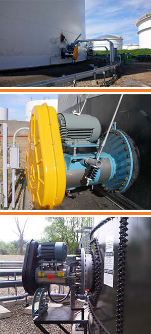

I have a customer that has requested a tank designed to AI650 standards with the exception of adding an agitator in the sidewall. Has anyone ever come across this? I'm not really sure how to approach calculating a safe wall thickness. Any recommendations on where to find information to solve this issue would be appreciated.
The agitator supplier should provide complete nozzle loads (overturning moment, operating torque, dead weight at a minimum) and you should input that into a nozzle analysis to confirm will be well. Request the mixer vendor's maximum deflection criteria (stiffness) because the flexibility of the nozzle supporting the mixer is the limiting factor, not simple stress in the tank wall. API 650 does not have stiffness criteria but agitator suppliers should have one. API 650 Annex P may be of interest to you but I've heard that tank analytical software is preferred for this.

I have a little experience with sidewall agitators (also called side entry) in large diameter tanks..
My experience has been that these agitators usually are applied to large diameter tanks where a somewhat viscous fluid must be kept moving.
(e.g. Crude Oil Storge tank)
They usually are working in groups on large diameter shells
I am curious why he has insisted on a single sidewall agitator .... He only wanted one, right ?
- Do you know more about the tank size, temperature and nature of the fluid ?
- Has he expressed a desire for a certain vendor and a specific model agitator ? If so, I would contact the vendor
- Contact SPX, they make robust side entry mixers and have details that are typically given to tank fabricators
- Bear in mind that some mixers require auxiliary supports and some do not .... they CANNOT be added in the field after the tank is commisioned ... These robust clips must be accurately positioned .... You must know which agitator your customer is selecting !
As stated above ... Location of the agitator manway elevation must consider minimum tank operating level !!

Several good points and I'll add to this one. The right quantity and arrangement of side-entry mixers is a balance of having the mixers work together to generate a predictable flow field, and incorporate as much of the tank volume as possible in the bulk flow. However, too much mixing energy can also cause issues and excessive nozzle loads. It definitely makes sense to confirm the process fluid and have the mixers sized and located to produce the best effect (BS&W control and blending do best with different side-entry mixer setups). Asphalt requires special consideration because it may require steam line service to keep the seals from sticking shut.
It is rare to see a single side-entry mixer produce quality mixing. A normal number is two to five for an API 650 floating roof tank.

Thank you everyone for your help and suggestions. The tank is a stock tank @ 130°F adn SG 1.0 for a papermill, the agitator brand and model is specified by the engineering firm designing the facility, they provided me the forces and moments from the actuator for design. They just didn't spend the time on the tank design and instead called out "per API650" for shell bottom and side wall. Overall it's a small tank 16' diameter with a sloped bottom. The engineer has located the nozzle in the tank I'm waiting for information from Selzer on the agitator insert the engineering firm specified a "SI-24". I did run a few scenarios using compress to look at nozzle loading (thanks for the idea David!). This looks like it will be a good solution once I get the actual info on the insert.

Most side entry mixers I see are installed in shell manways. API 650 gives guidance on thickening the manway components for such circumstances.
Most of the side-entry mixers offered by the major vendors have giant motors with belt or chain drives ....
IMHO, this implies significant nozzle/manway loadings

Philly Mixers have these models: (Note the neato mountings on the tank shell !!!)
