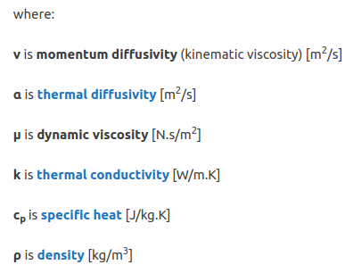

My problem seems to be that there still is some variables that is missing and therefore my calculations don't give me a result. For now I miss the Prandtl number and can't continue.

Prandtl number is a dimensionless number, Per this page for air use Air at room temperature has a Prandtl number of 0.71.
If you are working on a paper you should research the original source. There is some indication on the linked page that a good place to look is property tables, which is not an original source.
the units should cancel to dimensionless if you start with the correct units. The number may be temperature dependent.
