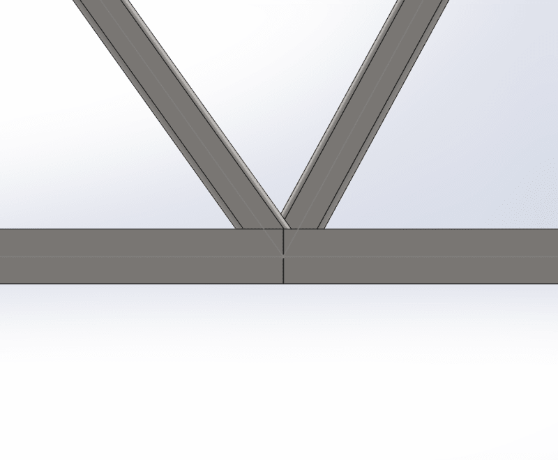

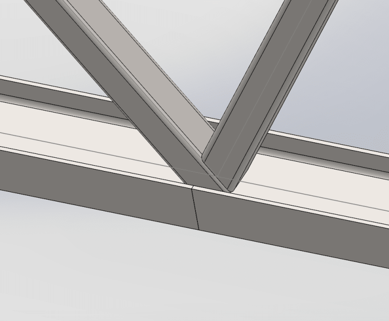

Hi all,
I am currently designing a truss with IPE 140 (I-beam) as chords. The beam however is rotated on its side, meaning its web is horizontal. The truss will have square hollow structural steel diagonals which are welded onto the horizontal web.
While checking those diagonals in the Eurocode EN 1993-1-8 I realized they only offer formulas for the case where the beam in the chord is vertical! (see attached). I tried scouring the rest of the standard and some additional literature but I could not find a word about my case.
My colleague suggested using all the dimensions from my horizontal web case and inserting them into the formulas meant for a vertical case (this means essentially switching around the height and width of the beam as well as changing its thickness) and the joint passed!
But I am of course not comfortable with this, nor am I sure that this is correct.
Has anyone met with this before? What was your solution.

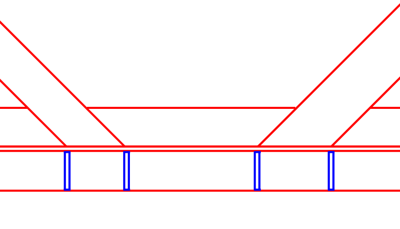

1) Yeah since I was planning on gap joints I was expecting some eccentricity and was planning to take into account the resulting moments.
I planned to simply add this to the axial forces per formula 7.5 below.

3) This is the current solution(no more gap in the joint and no more eccentricity), but I am still not really sure whether it wont change to a gap design.

Thanks for the suggestion, but do these stiffeners make sense with the sketch of the joint I attached?
Absolutely. The stiffeners are an excellent suggestion if they would not be economically objectionable. I should have proposed them myself. It's always better to move connection loads around via plate in plane forces rather than plate transverse bending.
Is there any chance that your webs could be wide flange members of the same. nominal depth as the chords?
This is potentially a pretty strong setup too. You'd have to consider weld access etc though.
The answer is maybe - it depends on what the capacity of your WF web is to resist the forces that your gapped or overlapped K-connection will impart to it. In lieu of an explicit analysis of the web, a stiffener (or even 2), might be a bit of an adder to the fab cost, but it's also cheap "sleep well at night" insurance for the designer. It's cheap in the sense that fab cost of the stiffeners pales in comparison to the whole thing falling down. :)
I agree with Koot, however. I would apply the RHS provisions should cover to this, because it's essentially the same situation.

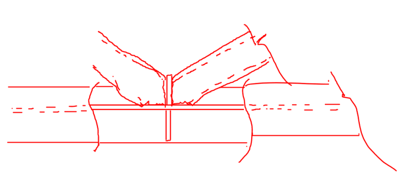

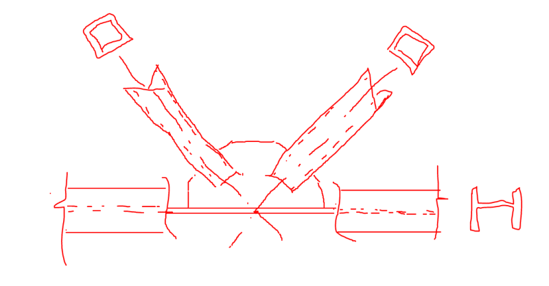

Let's say that someone came to me with only the following constraints on this and wanted to know my recommendation for the connection:
1) HSS webs.
2) WF on the flat chords.
My recommendation would probably be the detail shown below.
