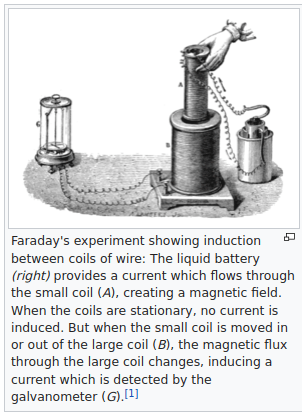

What exactly creates the torque with in a motor? Does the rotor or armature diameter and length have any affect on it? How about the number of windings? All with one specific supply voltage.

Strength of magnet is proportional to the number of ampere-turns (for an electro-magnet design). More turns and/or more current means more magnet. More magnet means more torque.
Current and voltage are related through impedance (Volt / Amp = Impedance in ohm).
So ... to get more magnet from a fixed voltage supply, either winding impedance has to go down (to allow more current to flow) OR the number of turns has to go up (without increasing the impedance).
Other factors also come into play: thermal stress on windings, geometry for positioning the requisite number of poles involved to handle either the current (DC machine) or the speed (AC machine), desired performance (i.e., operating efficiency), etc. These factors also tend to have influence on the diameter/length of the active material (rotor and stator core iron).

So if we have a steel or iron rod, with say 50 turns on the coil around it and 1.5 volts DC applied to the coil.
Then another same size and material rod with 300 turns on the coil, and same 1.5 volts DC.
I forgot the wire size I used 40 years ago doing this, maybe it was 27 ?
Question which of the above coils will have more magnetic strength?
And which of the above coils uses less power?
Some times engineering professionals need to look back to the basics.
Even if the wire cross section were equal, the one with 300 turns would have more resistance and thus draw less current. If it were the amount of copper held constant then this would be even more pronounced.
Finding the optimum, is why you pay the specialists the big bucks.
The torque of the DC motor or ac motor is proportional to the magnetic flux and current drawn by the motor. The current produces the magnetic flux which interacts with the main flux and produces the torque.
And now we see that it is possible to get more magnetic strength with less electric power.
