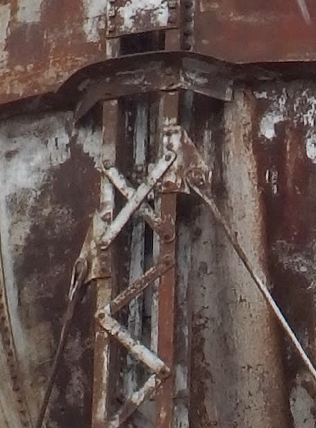

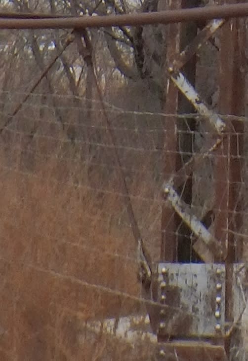

Some of the old water-tower turnbuckles have ends that come out and form two little loops that go around a pin. Those may have been hand-forged, I'm not sure if that was ever a manufactured part.

Edit: Sorry, I was just trying to show the end pieces, and added the turnbuckle per the comment below. These were pictures of the overall tank, so they are cropped severely to get the items in question, which is why they are not so sharp. The turnbuckle looks like those rods may have upset ends, but I can't tell for sure. The outer ends look like the funky forged double-loop I mentioned, but I can't tell for sure- it may be a welded-up assembly. The reason I show them, without having some way of evaluating the strength of the end connections, it may not matter so much what the turnbuckle capacity is.
Those are not turnbuckles. They are eye bars. There may be a turnbuckle on the bar somewhere, but I can’t see it in the picture.
