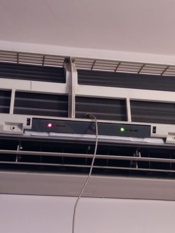

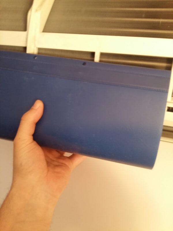

Just took some measurements with a K-thermocouple device I have put together.
Outside ambient temp: 15 C (59 F)
Probe temp (photo 1): 50 C (122 F)
Probe temp (photo 2): 60 C (140 F)
Should I surmise that the refrigerant temperature as it enters the indoor unit will be a bit over 60 C (140 F) in this case ?

Differential temp of 45 C sounds about right. Most A/C system struggle to reject heat once you go past about 50C air temp to deliver 10C cool air so the reverse looks right as well.
