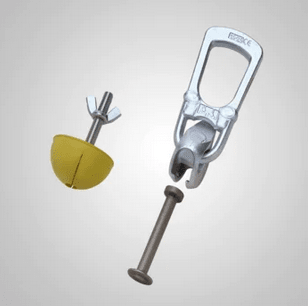

It is often convenient to design (or purchase) standard lifting lugs that can be tested and given a rating. example: HALFEN DEHA KKT Spherical head lifting anchor system:
Link

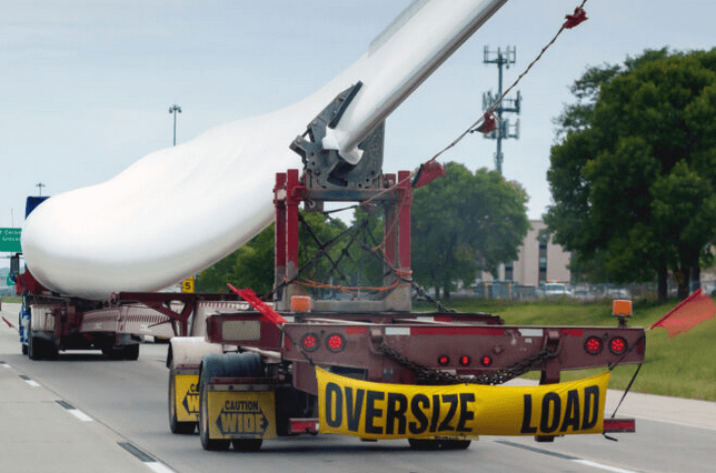

Sometimes lifting and transportation loads control the design rather than in service loads. When cost effective this can result in a structural shipping jig being used to protect the shipped product.
