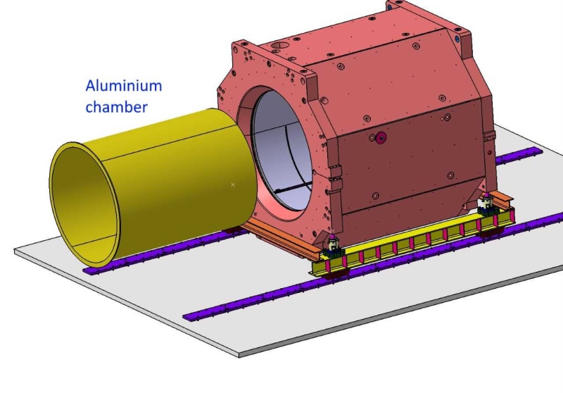

Hi there,
We need to insert an aluminium chamber (around 2 meters - 6.5 feet in diameter) into a magnet. It is 3 tons. Room temperature, clean environment. The total length to move is 8 meters -26 feet)

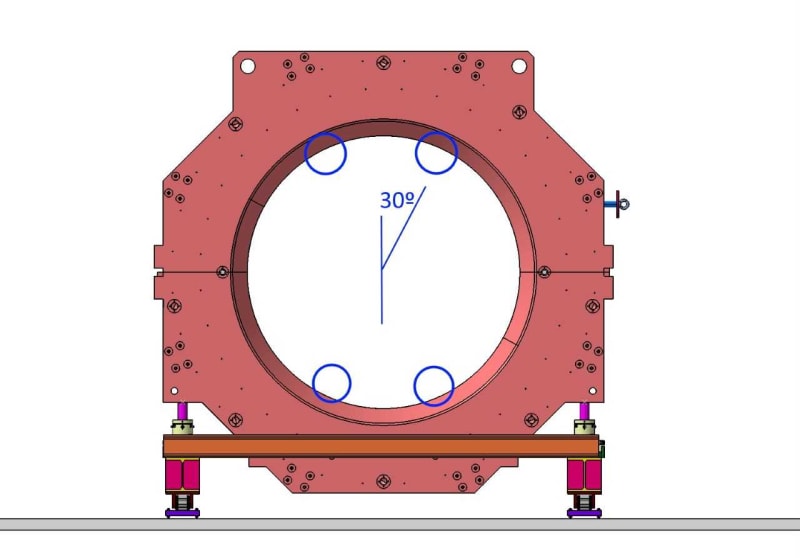

The idea is using rails. There will be some holders at +/- 30º (vertically).
The rails can't be bigger than 25 mm/1 inch.

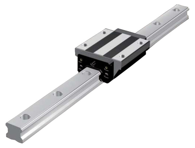

I was thinking to use precision linear. They can easily take the weight, they can slide the chamber accurately.
The problem is that these rails must be non-magnetic. I talked to many companies and they don't offer anything non-magnetic (austenitic stainless steel). I found some made out of aluminium but they can't take the load.
I can't believe there is a standard solution for this. We are starting to thing to prepare two surfaces on both the magnet and chamber and slide with PTFE in between.
Does anybody know any supplier providing non magnetic rails?
thanks
regards,
Here a couple of pictures:

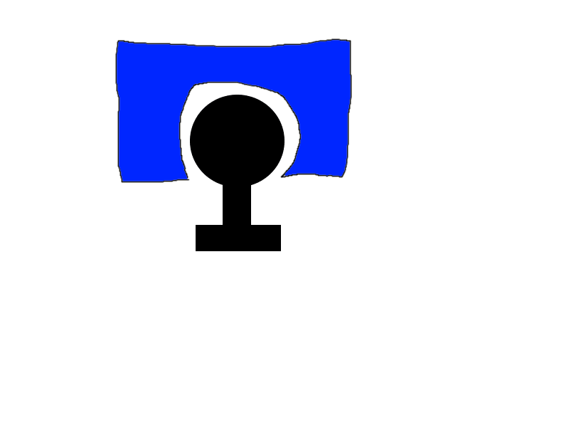

There is enough unsaid in you problem description to fill a fairly good sized book. 6.5' dia. and 26' longitudinal travel of the alum. chamber, in a straight line, from outside the magnet to its final position inside the magnet, seems understandable. But, which moves, the magnet or the alum. chamber? What are the dims. (thickness, length, i.d and o.d., otherwise it’s a perfect cylinder) of the alum. chamber and how is it supported during the various phases of the operation? How does it deflect under this support system? What’s the i.d. and length of the magnet? It looks like the magnet may move longitudinally on the blue rails, and if so, you support the alum. chamber on the inside with a “Y” shaped deep beam, 28'+ long and move the magnet over/around it. Your rails only have to be longitudinal guides then, more or less. But, you say max. size is 1", and do you mean 1" space btwn. o.d. of alum. chamber and the i.d. of the magnet? Make the “Y” shaped deep beam out of laid up fiberglass, supported at each end by small support frames. That’s 6000lbs. over 10' of a 28' long “Y” shaped beam. How close to the magnet can you get with steel structure and support on the outside?
If the alum. cylinder moves into the magnet, then you need an outside support rail system (steel?), under the alum. chamber, to line things up so you can start pulling/pushing the cylinder into the magnet, kinda like your first picture shows things standing. My bot. rails, the loaded rails, would be .5" thk. x 6 or 8" wide by 26' long alum. bar stock. They would be shaped to match the i.d. and o.d. and the inside would be lined with thin sheet PTFE epoxied/bonded to the alum. rails. There would be a least four load shoes on the alum. chamber which would slid on the longer load rails. How does the alum. cylinder deflect under these conditions? And, your two top rails are still just guide rails. Then, how do you get those rails out of the magnet, when the alum. cylinder is in place? Can the rails and load shoes stay in place? You might go back to my first scheme and put the “Y” shaped beam on end frames on rollers, which would allow the alum. chamber to be moved longitudinally along four guide rails inside the magnet.

The NSK link is for bearings. I called them. They said they can make the rails for us. But it is not standard; which means long delivery times and they won't be cheap. I gave all the information, let's see what they come up with.

There will be a temporary aluminium profile structure with additional rails (aligned with the ones -permanent- inside the magnet)

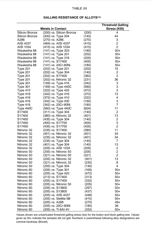

In one case we used a high strength bronze, there are a bunch of Cu alloys that might work.
You could also just make them out of Nitronic as well, it doesn't like galling to itself.

The Nickel Institute has an excellent paper for selecting material couples for sliding bearings.
From this chart, if you make the sliding bearing from Nitronic 60 you can make the rails out of essentially any stainless steel or titanium that satisfies your other requirements.
