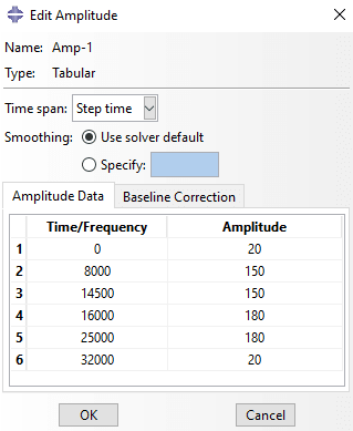

For the heat flux I just realized that I did add one. I'm trying to mimick an autoclave process. For this I needed the model to pass through different temperatures at different times, to achieve this I added an amplitude, with the time being in seconds and the amplitude representing the temperature in celsius. Is this correct?
Here is the image of the amplitude.
Yes, you can do it this way. Just remember to specify a magnitude of 1 for the BC or load using this amplitude and to stick with Celsius units for the rest of the analysis setup.
