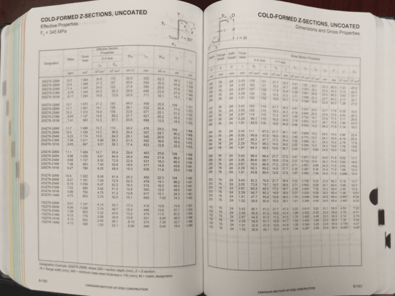

Anyone know where I can find a LGSI Framing Systems Design Handbook? Been seeing on threads there's a good one from 1990. Been hoping to find something on z purlins that is similar to the flexure tables from AISC handbook.
Z-girts seem to have disappeared from the generic catalogs. You may be best served by using supplier specific information like this (Canadian unfortunately): Link
The Canadian steel handbook actually does have a section useful for the preliminary design of Z-Girts. The units are obnoxious to those of us brought up stateside but perhaps this will still be of use to you anyhow.
