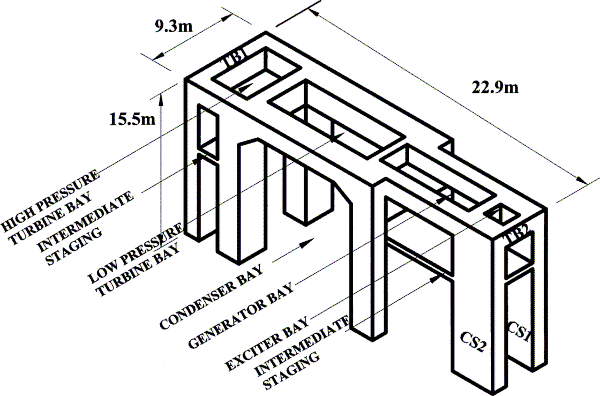

This type image gives the illusion of a solid "table top", which is misleading. Because of sizeable penetrations for equipment, the pedestal is shaped more like "Swiss cheese":
The dynamic analysis should include the legs, the foundation, and probably any piling. A high-tuned pedestal is superior to low-tuned.
