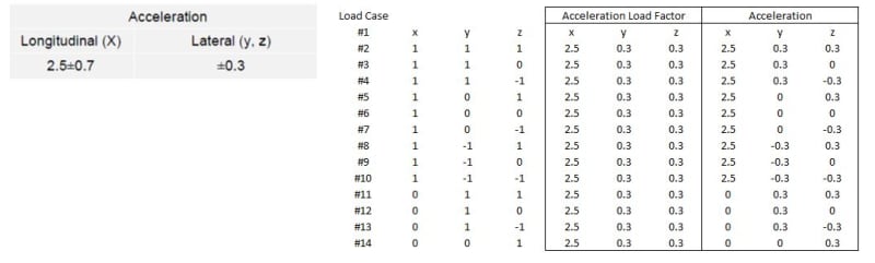

Another concern is if combined load factors shall be considered? Either to apply the G force in three axis at the same load step or calculating the combined margin based on the result from each axis load condition?
That's a mistake I often see. Typically the force in the 3 directions are uncorrelated in the time domain, hence you should test with 1, 0 and -1 scaling in each direction, which in a linear system gives you 13 tests
x y z
1 1 1
1 1 0
1 1 -1
1 0 1
1 0 0
1 0 -1
1 -1 1
1 -1 0
1 -1 -1
0 1 1
0 1 0
0 1 -1
0 0 1

Hi Greg Locock,
Thanks for your sharing. Is the below what you are pointing?
That looks right. If the system is linear the superposition of load cases can be done at any stage in the analysis. If the system is non linear then you need to do each run separately.

sorry , but is it ?
particularly if az is between 1.8 and 3.2 ?
but if you number unit cases in each direction, wouldn't you run 5 unit cases (assuming X only +ve), then factor these together ...
case1 is 1 m/s +X
case2 is 1 m/s +Y
case3 is 1 m/s +Z
then 2.5 m/s X 0.3 m/s in Y and Z is 2.5*case1 + 0.3*case2 + 0.3*case3 ?
unless that's what people meant, or unless I'm wrong (again) ...
I can see that you may want to run the full gamut of cases (+veY and +veZ, +veY and -veZ, -veY and +ve Z, -ve Y and -ve Z, +veY only, +veZ only, -ve Y only, -ve Z only)
and combine these unit results to achieve what you want.
is +veY only = (+ve Y and +ve Z) + (-ve Z only) ?
