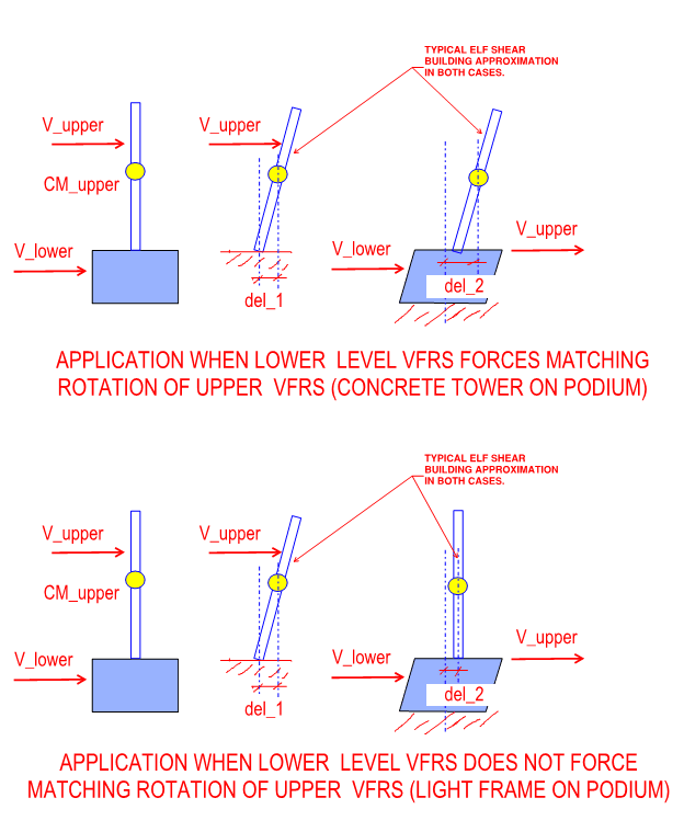

My overall impression of this is that, for the right kind of building:
1) The simplified, two stage, ELF analysis method should be sufficiently accurate and;
2) The "punishing" loads that the two stage method produces on the podium level are the right loads. This makes perfect sense to me for the "right" kind of building because:
a) If it's flexible over very rigid, as intended, then there's little doubt about the upper stories delivering load to the lower as if the lower were a fixed base.
b) If it's flexible over very rigid, as intended, then the standard shear building approximation that throws faux mass from the podium up to the upper structure is invalid. The substantial mass inertia of the podium structure belongs with the podium structure.
The trick is in determining what kind of buildings are the "right" ones. And, frankly, I feel that we could do this much better than ASCE currently does it. See my proposal below where the metric of interest would be something like del_2 / del_1 < 0.1 (or whatever limit makes sense). In particular, note how this would play out differently for two very different kind of buildings:
a) Buildings where the podium LFRS enforces a matching rotation of the upper LFRS would be far less likely to qualify for two stage. Less concrete towers.
b) Buildings where the podium LFRS does not enforce a matching rotation of the upper LFRS would be more likely to qualify for two stage. More light frame over tanks.

Koot K., I agree with the first half of your post, not sure I follow the second half. What is del? It seems to me rotation plays a bigger role on buildings with small footprints and shorter shear wall lengths. Is it your intent to make it harder for tall slender buildings to qualify for 2-stage?
