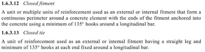

I was reading the definition of "Closed fitment" inthe code, and I notice that the definitionof "Closed tie" is quite different, and I feel what they meant when wrinting 14.5.4 was closed ties, not closed fitments. In this case the commentary would be in accordance with the clause form the code. See below

Code says
10.7.4.3(iii) requires 135 degree on all bars
except
10.7.4.3(iv) which relaxes this to 90 degree on alternate bars for certain cases. And vertically the 90 degrees cannot be on the same column at every set, they must alternate over the length of the bar
14.5.4 says that 135 degree on all bars is required above the nominated limits.
The commentary agrees with this.
Not sure what happened to the phi in 10.7.4. There was a typo in the original draft in 10.7.4 and it was supposed to be changed to a phi, but it appears to have been removed entirely. The original Seismic clause in 14.5.4 always had the phi in this limit. I cannot remember if this difference was pointed out before, but we cannot fix things we do not know about. Unfortunately repeating the same limits to try to make sure they are not missed has come back to bite us this time.
