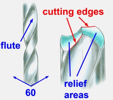

I recently got into an interesting discussion about using profile of a line on the sharp edge of a fluted drill bit. Though it's not 2-D (it's helical), would the statement above allow for such an application? I don't mean to deviate from the main topic of the OP, but I have my own feelings about such an application.
Belanger,
Excellent example for the exact issue I was addressing. This is THE type of geometry that doesn't fit with what the text of the standard requires for the establishment of the tolerance zone.
What are your feelings about it?
When the question was posed to me, I initially thought that profile of a line might be plausible. But I looked at the exact verbiage in the standard and it seems pretty strict that we're limited to 2-D geometry, so profile of a surface would be the way to go. But to avoid confusion, I did recommend that they add a small note to clarify.
Belanger,
What would the profile of a surface apply to? The V shaped twisted sharp edge itself or the surfaces that form it by their intersection?
Although the intent was to follow the path of the curve, the profile of a surface tolerance was applied to one face/side of the cutting edge. (If it were applied to the sharp edge itself, we'd get into all sorts of issues such as that raised by the OP.)
Do you mean it was applied to the "relief areas"?
Sorry -- not the cutting edge in that sense. It was a designated portion of the fluted areas.
Interesting.
The cutting edge is formed by the intersection of the relief areas and the flute. If the cutting edge is to be controlled by profile tolerances indirectly, both the end of the flute and the reliefs have to be controlled by profile of a surface.
