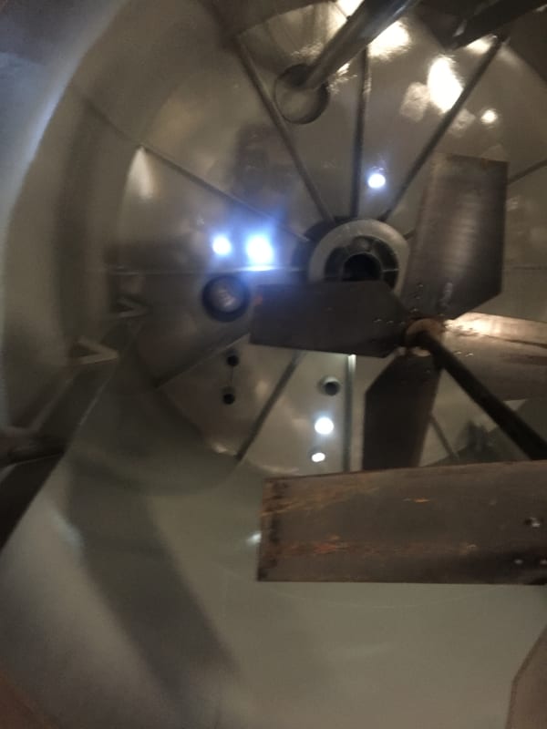

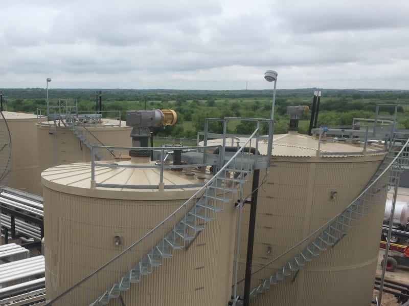

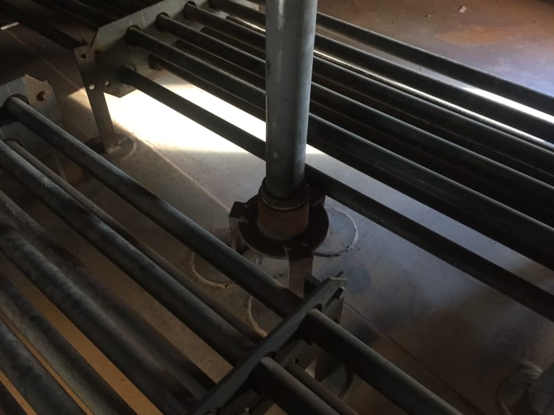

Three images from a similar install for asphalt. We use a heavy weight such as a W beam or section of railroad steel to hold the floor deflection down till the steady bearing is installed if needed. The product will hold it down in service and when the mixer is running. Note that the roof must have internal or external rafters to support mixer uplift forces and weight...a vertical mixer shouldn't just be added to the roof of a typical API650 cone roof tank (that at smaller diameters won't even have rafters). The 40' height is a bit extreme...we try to stay at 34' to keep the mixer shaft from being humongous.
