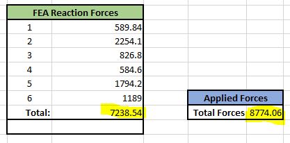

Thank you for response guys. The requirements for this project has changed (as always) since my first message and I ended up generating and FE model in ANSYS.
This model is a bit more representative to the reality. You will find several load cases if you open the file. My reaction forces are short of 1500N roughly unfortunately. I have tried to run the simulation with different load cases but there was always a significant amount of reaction force missing. I am not entirely sure what’s causing this. Would someone be able to take a look at to see find the problem with the simulation?
Thank you for your help.
"This model is a bit more representative to the reality." ... no it isn't. there is "clearly" a problem with a model where reaction .NE. applied load. Clearly, since the FEA balances (it Has too) there is a seventh support reacting some applied load. You are better off, IMHO, in solving this by hand (since it is QED), and then (if you want the practice) solving with FEA.
Well. I messaged in my previous comment that there is a problem with it as you pointed out. Otherwise, I wouldn't have shared it on this forum.
yes, but you start with the quote, which is wrong.
and this is a "bad" way to approach the generalised situation (which is what I thought you were after when you used variables for dimensions).
this is "easy" to put into excel ... define the geometry (positions of the 6 legs, position of the load) and excel can calculate the results.
I would start with a s/sht that had 4 reactions ('cause it's easier to check) then make a 2nd sheet for 6 reactions.
I suspect you have an errant constraint (maybe AUTOSPC ?). Which FEA are you using ? There should be a table that shows the sum of the input loads and the sum of All the reactions and their difference, which Has to be zero (or round-off error).

I would expect any decent FEM software to solve this with a difference between allied load and sum of reactions < 1%, probably < 0.1 %. If you are using Ansys you are not using it properly. Maybe, as rb1957 suggests, some AUTOSPC is "stealing" the load.
If you neeed a quick result I suggest doing it by hand, as already mentioned. But if you want to use FEA, by all means. The model you have may be more geometrically correct but the results are off. Before you use any reults you need to find the missing load and ensure that the load and boundary conditions are correct. There is no way around that problem.
