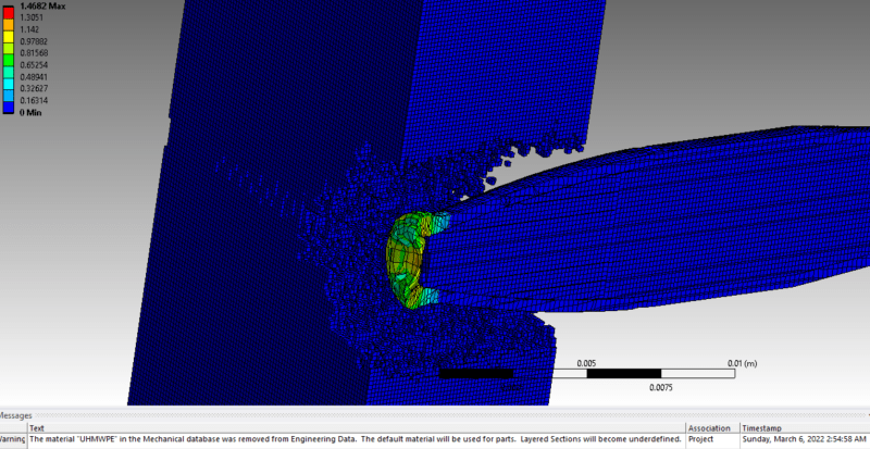

Ran the simulation a couple more times trying different things. Ran it with a .005" gap between the armor layers, still resulted in errors. I read the manual on modeling composites in ANSYS and my values are correctly inputted according to the manual. Ran another one with only UHMWPE and this is where it gets interesting.
It is doing the same bad behavior now. Also, I clipped the error message that I am greeted to every time I open up my files. It says UHMWPE is removed but doesn't elaborate on why. Also, notice the date, this was on the 6th the message appeared. Back on that day I was trying to get a accurate model of UHMWPE inserted. The correct simulation ran when that message was present. I don't know if it is still doing this or not; when I initiate a solve, it does say UHMWPE is successfully loaded in. Not sure what to do here, could the save file be corrupted causing this loop? Deleting UHMWPE material and re-creating it hasn't fixed it either.
This warning might be due to deleted material property or due to changed geometry and the since the material is not assigned Ansys is assigning default material to the updated geometry. To avoid this just remove default material - structural steel and keep the materials which you need. Other option in mechanical - File=>options=>Geometry=>Assign default material to new bodies on update=> No. By default its No. But check if its changed to yes. If above setting is no and the geometry update contains new body without any material assignment, the body becomes underdefined (with ? mark) and you need to specify the material.
May be you have solved with the wrong material when that message was displayed since the material was changed to default. This is my guess though. For correctly applying material properties do not keep the materials which you don't need in engineering data.
Another thing be extra critical of your simulation. Sometimes there are simple mistakes like missing decimal place, input of wrong numbers, using wrong units, assigning different material property altogether, making mistakes in choosing the correct options, setting the wrong options. These things get overlooked as you spend more time in simulation since you get "feel" of everything is correct. Check each parameters carefully.

I believe you are correct in this, a different material setting was used. I discovered that whenever I change material settings in engineering data it doesn't refresh if Mechanical is open. I had Mechanical open while inputting different values and trying to run it. So sadly, I have no clue what material properties were used in the good simulation. I ran a ton of quick coarse simulations of a ball hitting a UHMWPE plate trying the different values journals used and none behave the same way as the good simulation did. The data from that save file is long gone too from running multiple simulations and it corrupted itself yesterday. Really is a shame that ANSYS operates in the most archaic way (seriously, why does it not update the material property when I change it...), but thanks for the help! Hopefully I can figure out the model I used to get those results somehow.
So, to wrap this thread up, the problem was Mechanical doesn't update material changes without exiting and reading the upstream data again whenever the material is changed. This caused me to have the wrong material data in engineering data than what the model had used, so when I ran another simulation of it, the model was different and it seemingly was acting different from the ceramic data fix.

You can update/refresh the materials after doing changes in material parameters either in mechanical=>model=>RMB=>refresh materials or in project window=>RMB on model=>update, when the Ansys mechanical window is open.
