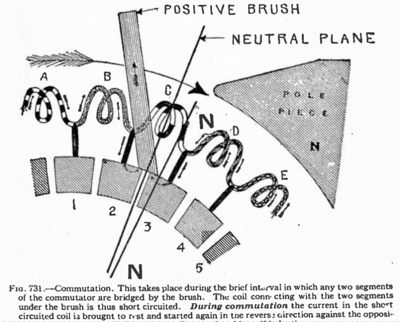

It is really hard to read resistances as low as you should have with a DVM.
Most commutators have insulating material between the bars. Adjacent commutator bars are "electrically close"
Audel's NEW ELECTRIC LIBRARY VOL. II said:
