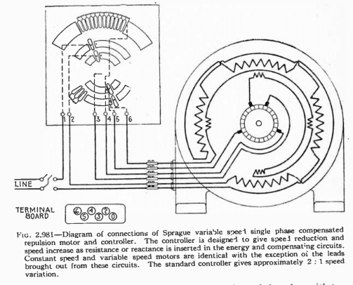

There are also examples of slip ring and commutator motors that adjust speed by changing rotor resistance or shifting brush position.
Audel's New Electric Enclopedia said:
