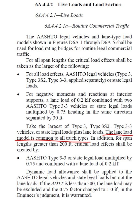

I am performing an AASHTO LRFR legal load rating (Type 3, Type 3S2, 3-3, etc.) for a single span bridge less than 200 feet in length. Should I include the lane load (0.64 klf) with the legal truck? In my opinion the wording in the MBE isn't clear if the lane load should be included or not.
My reading of the MBE is the lane load isn't required in your case. I looked at what was done on a recent project in our office - single span bridge, 60' long - no lane load with the 3, 3-3, & 3S2 trucks.
On NYSDOT-owned bridges those trucks aren't required but municipalities are free to include them.
For our load ratings, none of the legal load trucks are combined with lane load for any bridge.
In my opinion the wording underlined in red could be written in a more clear manner. It's clear that there is a lane-type legal load model that is also used, but the wording makes it appear that there is some kind of lane load that is applied with the Type 3, 3S2 and Type 3-3 truck.

Except that if that were the case, there would be no need for the load combination in the bullet point following the red underlined portion, since it would never control over the Type 3-3 + lane at their full scale.
The red underlined statement only means that the lane load is not applied differently as a state legal load, an AASHTO legal load, or an AASHTO design load.
Also notice the position of the comma in the sentence before the underlined one; you take the largest of the [AASHTO legal trucks] or [the state legal trucks + lane]. If the comma was after "state legal loads, then it would be the [AASHTO trucks or state legal loads] + [lane].
Nah it's poorly written and a good example of something a committee created. "Common to all truck types" could be easily understood as the three types of trucks mentioned in the previous sentence.

On bridges with longer spans, it certainly can for design. The standard lane load (0.64 klf) is not combined with the standard rating vehicles for load rating. Only the reduced lane load (0.20 klf) is used in combination with the state legal load trucks as specified in the excerpt above:
- With the 75% of the Type 3-3 truck train when considering negative moments at interior piers, or
- for spans greater than 200 ft, a single Type 3-3 or state legal load truck.
