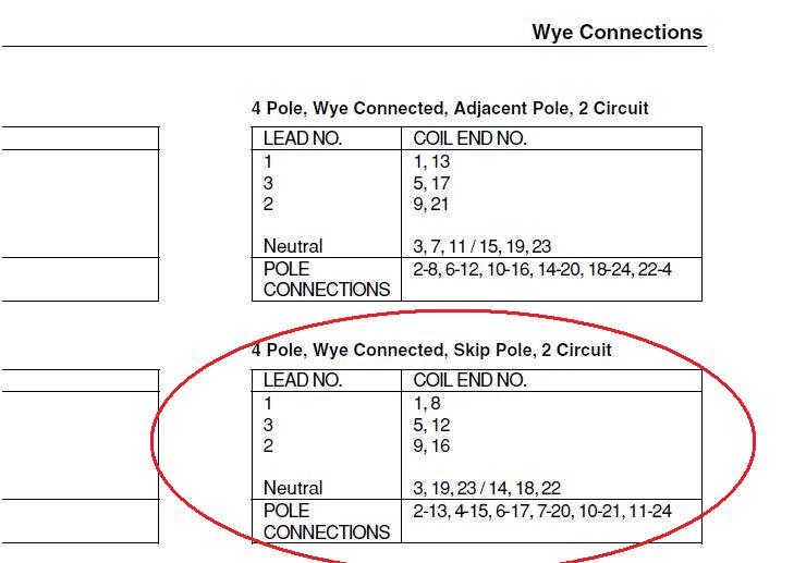

After chewing on this for a while, I have a question: Is it possible this was built with two separate Y configurations (see the attached drawing)? It's a dual speed motor, would wiring these windings up to have two internal Y configs work? If you switched power on to one set, you'd get half speed, and then full speed with both? I've never seen this before, and I'm not sure it would even work, but it's the only way I can explain that strange continuity.

The motor with continuity between 1-4, 2-5, 3-6 has an open winding. You may use this for star/delta starting, but not for two speeds. The other one seems to have two star windings. This might be a two speed winding.
The diagram appears to illustrate a common 4 Pole, Wye Connected, Skip Pole, 2 Circuit winding connection.
Leads in the OP's illustration identified as L1, L2, etc are shown outside the diagram suggesting a six lead motor.
In this instance, the “L” leads would be connected internally and brought out as three individual leads L1, L2 and L3.
Both neutral points shown in the OP's diagram can remain separated or tied together as well.
