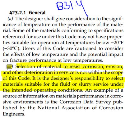

SJones, I am following B31.4 and it says that
@Muhammad
OK - if you are using B31.4, then you have supercritical CO2, and I can't see PSL 1 being acceptable for that. CO2 is transported in carbon steel pipelines - what has your corrosion assessment told you about the suitability of carbon steel? A simple Google search for CO2 transport pipelines will give you some background to discuss with your client.

SJones, thanks, yes its super critical but the problem is my client asks for references from codes, either I suggest API 5L PSL 1 or 2 he will ask for reference from code and as much as I know (after reading API 5L) I am unable to provide any reference from code, its confusing for me as a junior engineer, may be its easy for you guys but challenging for me.

Now you have flipped back to multiphase hydrocarbon. It’s apparent that the issue is a bit beyond you. You will not find anything in the codes because, as you show in your copyright infringement, codes do not address weight loss corrosion issues caused by CO2. That is the domain of the corrosion engineer. Perform a search of Eng-tips for the term “CO2 corrosion modelling”

We are still trying to determine the exact question, but it appears to relate to whether ASME B31.4 will define which linepipe PSL applies, and how much corrosion allowance is needed.
