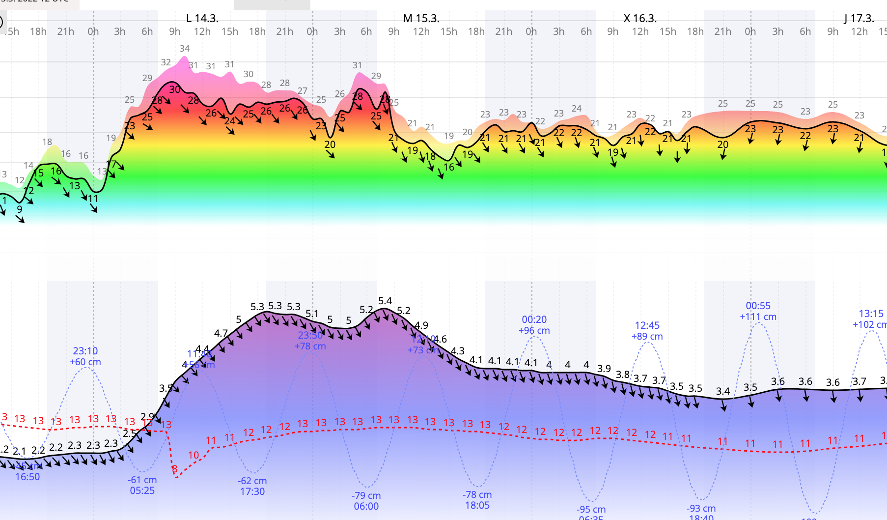

Tide predictions here for 15th & 16th may reach 6 m (20 ft).
A black swan to a turkey is a white swan to the butcher ... and to Boeing.
In the us, shows real time water levels.
Modeling of future tidal and tidal area flood levels (about 1 week) is available at It's not tidal, but live level of rivers is available at NOAA River Forecast Centers

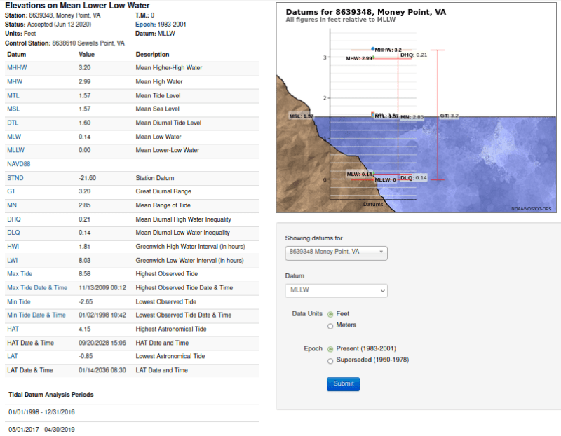

This is the published list of tidal levels at monkey point.
[URL unfurl="true" said:
https://tidesandcurrents.noaa.gov/datums.html?id=8639348[/URL]]
