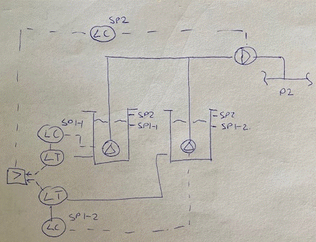

Hi
We have a pump configuration as below. Two tank pumps and a booster pump. P2 is fixed pressure. What is a good way to control these pumps?
Tank pumps on level control
Booster pump controls it's suction pressure. But this a packed water line, so will a pressured accumulator be required?
Other control loops options for the booster pump?
Booster pump controls the maximum current draw (or speed) of the tank pumps? no need to even look at the booster pump suction pressure.
There will times when P2 is low and the booster pump is not required. When this happens an NRV around the booster can open.

If you can justify VSD on booster to save on power, suggest:
1. Operate tank pumps as existing on level control at each tank acting on tank pump
2. Run the booster on flow controller (acting off FT on booster discharge) (which then acts on booster VSD) as a slave to new high level master controller acting off the current LTs' at each tank. Use a high level selector to feed the new high set master LC in DCS.
This way you wont need to look at booster suction pressure.
Other schemes also may be possible also, but this is what comes to mind at the moment. This scheme will also enable the booster to go to min speed ( while tank pumps do not slow down) and allow the suggested bypass NRV to open when delivery line pressure is low. See attached controls sketch

@georgeverghese
I like your thinking. Seems better for a process where we want steady flow response. At least one of the tank pumps would run at full speed, while the booster does enough to keep the highest tank level under control.
Yes, you've got the hang of it now. LC resetting FC on the booster may be smoother as I've shown on my sketch.
You havent told us much about what goes on the end of this line downstream of the booster. If demand at this user is transiently lower than what is delivered by these pumps and a valve chokes inflow at this user, the pumps upstream would all deadhead. Can the line handle full deadhead pressure? If not, a pressure controller would be required at the upstream end of this delivery line to cutout the output of the FC at the booster (via a low signal select) to limit booster speed, and as a consequence of this, a min flow recycle line would be required at the common line d/s P1 and P2. Min flow recycle controller setpoint should be calculated continuously in DCS to account for the number of pumps in operation and the current operating speed of the pumps.
