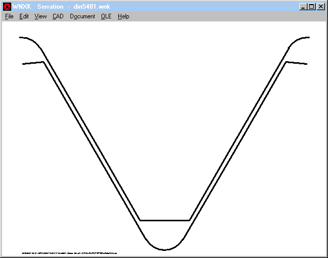

Here's the exact type of this spline. I quickly modeled it. Attached step file.
