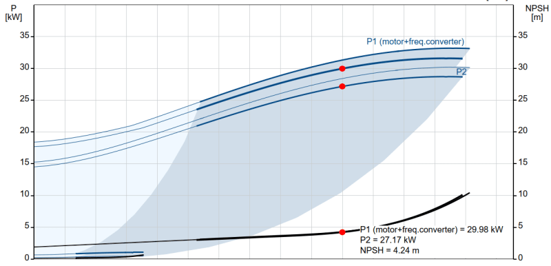

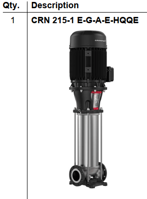

Apologize for my poor drawing, this is a Grundfos CRN Pump, hopefully this image would be useful.
for NPSHr, it is about 4.24m, i believe it should not be a problem.
I am worried on the operating condition to stop the pump at minimum level.
Feed coming into this tank is inconsistent(depends on production) and therefore these pumps will be starting/stopping based on level.
And for this case i would like to stop the pumps when the level reaches (1) which is the most minimum level as per submergence calculations. instead of (2).

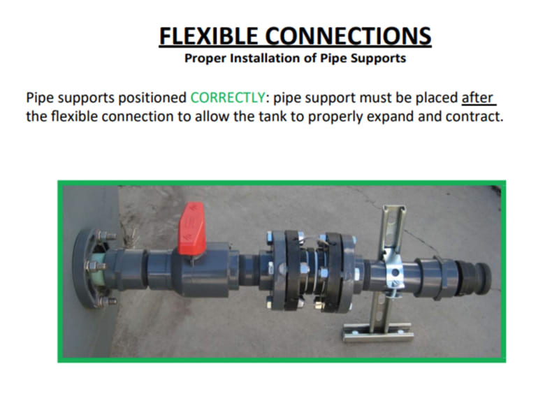

IMHO, this type of pump is a particularly BAD CHOICE when paired with a plastic tank. Is this a "repurposed" pump that you already have ?
If this is a new installation, why not buy a more conventional horizontal axis pump ?
Grundfos CRN multi-stage pumps have a very marginal base mounting and are prone to vibration as the pump gets older and worn ... The pump is basically an "out of control" cantilever ..... This will spell disaster for the FRP plastic tank nozzle.
How are you going to anchor this old used pump ? .... is the baseplate cracked or broken ? .... Send pictures
Additionally, you are confused and should not be talking about "total submergence" and "minimum submergence" ..... it is not appropriate for this type of pump. An evaluation of NPSH IS APPROPRISATE .... Do not confuse submergence with NPSH !!!
MJCronin
Sr. Process Engineer
Agree with MJCronin's comments. It is good engineering practice to orient piping to allow plastic tanks to expand and contract.
