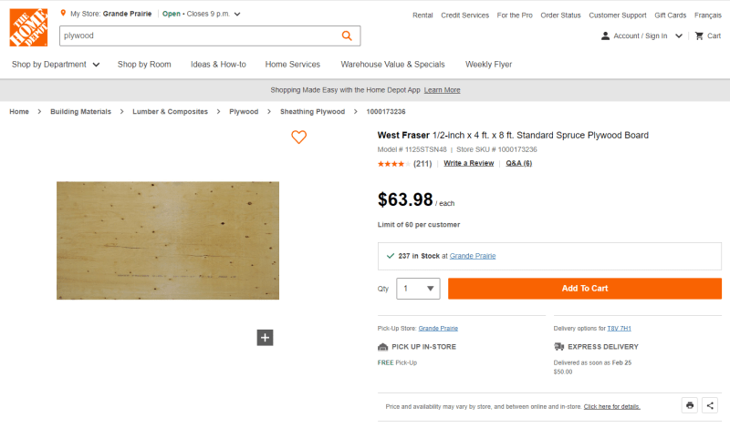

I understand that stance and given the other components are not treated it is logical. This would be a case where I would look at the cost difference. Below are current prices for plywood. If it were my building it would take me very little time to decide, but I have worked with many very tight clients that would object to the extra $4-$5k. You have made your argument, and put in print your preference. I am not aware of a code clause that would require you to treat this.

2x4's are pretty ridiculously priced right now also.
3/4 Advantech is like $87 last time I checked.
I framed my house in November and I thought I was getting bent over paying $57 for Advantech - now it seems like a bargain!
