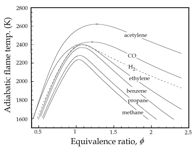

To a certain point lean flames are hotter, the average cutting torch shows that. If you go super lean then yes it cools, and that is how the TC-18 aircraft engine could obtain such a good BSFC.
Acetylene and CO, yes, but HCs are hottest very close to stoich, which is why NOx formation is a maximum there
The-adiabatic-flame-temperature-as-a-function-of-the-equivalence-ratio-for-various_acgp6b.png
Cheers
Greg Locock
That chart shows acetylene and CO hottest when rich - not lean.
Actually, what an average cutting torch shows, is that intense heat plus a strong jet of pure oxygen allows the cutting of metal via oxidization.
NOx formation needs excess oxygen molecules, and high temperature, so maximum NOx formation is just lean of Lambda 1.0.
