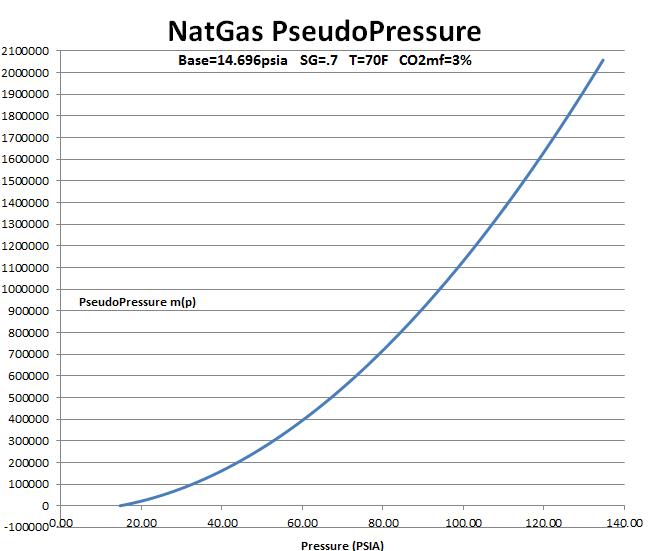

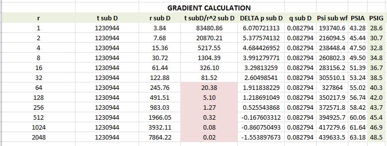

After a couple weeks of searching, then reading the "Gas Well Testing Handbook" by Amanat U. Chaudhry (Excellent Practical Text),
the preferred method for calculating formation pressure at a distance includes significant correction for viscosity and compressibility via the use of a "pseudopressure" method. From the text, it appears that this correction process is applicable for all cases ... or at least I haven't yet run into where it would not be applicable.
Conveniently Chaudhry includes a spreadsheet for calculating PseudoPressure from atmosphere through 4000 paia. Plotting Chaudhry's PseudoPressure points for this problem up to 140 PSIA looks like:

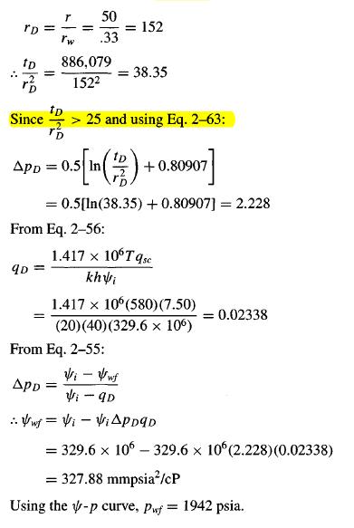

A sample computation of formation pressure at a radial distance looks like:

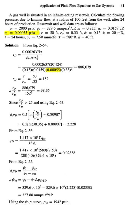

All of the parameters in his example are nicely defined down to practical units, however c sub i = 0.00055 psia^-1 appears to be a form of compressibility, but I cannot find any definition of this parameter or anything remotely that looks like it in any of the searchable literature. Since his example is two orders of magnitude higher in pressure, most likely this c number isn't applicable here. It looks like the last parameter I need to be able to compute the radius pressure.
Can anyone offer what this c sub i variable is actually defined as in practical terms?
(And offer any other comments about my application of this particular methodology.)

Good work!
It's the gas compressibility
Rough estimate using the compressibility of an isothermal gas, I suppose the "i" means isothermal.
P1 V1 = P2 V2
2000 psia x 1 any cubic volume = 2001 psia x V2
V2 = 2000/ 2001 = 0.9995 any cubic volume
Compressibility = ΔV/ΔP = (1-0.9995)/1 psia = 0.0005/psia
Including the natural gas compressibility factor z, I estimate as z = 0.85 to 0.9 at well bottom P & T.
Ci = 0.0005 / 0.9 = 0.00055

It makes sense that the z compressibility factor gets computed at each pseudopressure point. I was getting tripped up seeing compressibility used in there twice.
I had read somewhere that c sub i was the ‘Total System Isothermal Compressibility”, but I couldn’t nail down a hard definition of what that actually meant and how it is supposed to be practically calculated.
The ratios of the deltas clears that up the C question perfectly. Thank you!!!

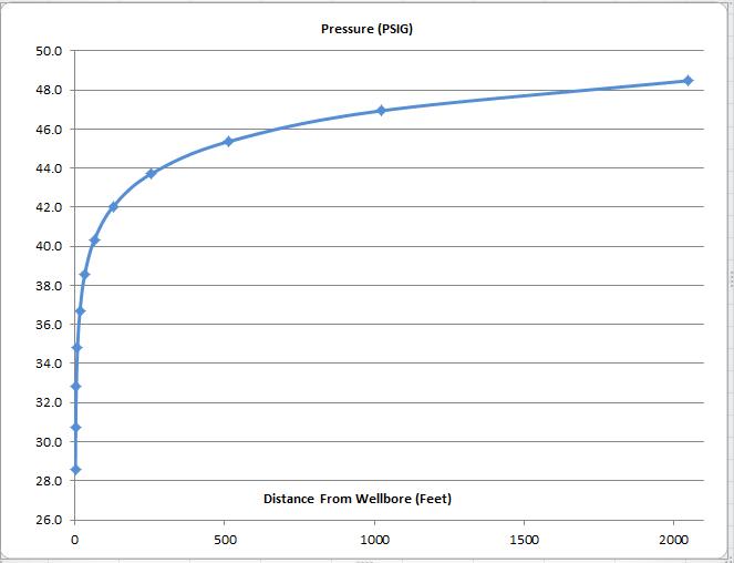

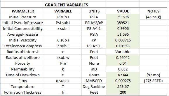

C sub i grew up near 0.01953 using 51.7psia as the range to compute it as you did. So it was a little more significant than I expected, but looks like a logical number.
I have no information on Permeability so being that was all that was left, I had to crank it way down to 32 microdarcies to get the wellbore pressure down to the measured value of 28.5 psig.
As a first look into what the pressure gradient could be, it didn't look all that bad.
The only really odd part about the curve was the gradient rose three psig above the shut in InitialPressure which clearly shouldn't be-unless gauge errors are lining up against me.
Looking back over the handbook, tsubD/rsubD^2 is required to be over 25. Based on that, radii 64' and higher fall below 25 and appear questionable which might explain the pressure plotting > 45.
The questions in my mind, is there a different set of calculation rules when this ratio goes under 25 or are we at the point of diminishing returns for calculation effort ... and does 32 microdarcies seem reasonably in the ballpark since we are talking such a low flow (275 SCFD in 200 feet of formation-no detail on any packers installed)?

32 MicroDarcys? = 32/1-E6 D 32mmD, calc shows 0.032, so its mD, miliDarcys.
A Porosity of 0.04 could indicate a permeability as low as 0.10 mD

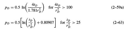

In regard to the formula to use in relation to TD/RD^2
There are 3 ranges that each use different formulas
Page 37 Example 2-6 And in Page 40 Example 2-7 Page 41
ΔPd is calculated using TD/RD^2 value >25 with eq 2-63 and 2-65 as seen on Page 35 and 37 are accompanied by other formulas for PD
when
TD/RD^2 >25 and
Eq 2-59a for when TD/RD^2 > 4 TD/RD^2
And 2-61 at the borehole
Note that on page 38 the Example uses the "pressure treatment" method". Page 39 gets into the "pressure squared treatment" with the same results and then page 40 shows the "pseudopressure treatment" using equation 2-65, for >25. Then, again with the pseudopressure treatment", Example 2-7 uses eq 2-63
I dont yet know what that does to your calculations, but it might be worth some effort checking into that.

Looking at the references still have me scratching my head. Basically it appears that the two formulae's conditions for use are effectively the same since (02-59a) just has both sides of the inequality multiplied by a factor of four. For the same r, the true/false tests of the inequalities evaluate identically. Or am I just missing something really badly?
I will have to review the use of P, P^2 and Pseudo methods. From everything I read, the PseudoPressure method worked for all pressure ranges ... but clearly the t subD/r subD^2 > 25 gotcha seems to leave loose ends even with Pseudo method. Since this gotcha seems coincident with the distant pressures being too high, I'd bet two rounds of beer that the discrepancy lies near there. Interestingly, I just ran the same spreadsheet for another well at about four times the pressure and it has the same less-than-25 problem for the gradient. He's doing a drawdown test and I am going to try computing his k. That will be interesting.
