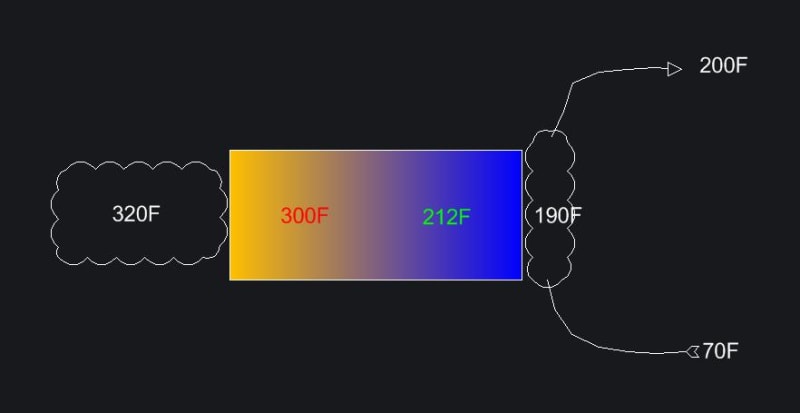

Let me present what I was thinking about at lunch.
Would it be possible that it's designed this way and actually expects enough coolant (H2O) flow that the water can't actually reach 212°F?
I'm told they, "Closed all the manual valves then opened them 2 turns".
But they're needle valves! That may be a minuscule amount of water?

The relevant parameter to compute with continuous flow is the film ( or more conservatively surface temp) on the hot end of the CW side of the cooling surface of this extruder - some idea of surface geometry, CW velocity, hi and ho are required to compute this parameter. Say we keep surface temp at less than 190degF max. Physical props and flowing parameters of the extruded material will also be required for this estimate.
You did say that the inlets are on the bottom and drains out the top?
You need to do that in order to keep the system full, unless you have wide open inlets and are controlling flow at the outlets.

Mint; You really think any less flow (smaller continuous) would limit the noise?
I didn't say smaller. I said continuous.
Enough flow to keep the surface continually wet. It can boil, or not, just don't let it go dry.
Ah Mint; That's just down this new road of maybe trying to keep the water cooled surface operating below 212F. Do that with the help of continuous flow. I get it now. Nice.
Ed; I believe all I said was the "feed manifold pipe is the top one" and the return is the bottom one. I think they both enter at the bottom of the cooling block. Which is probably eminently lame with regard to purging the air out of the space. Sheesh.
