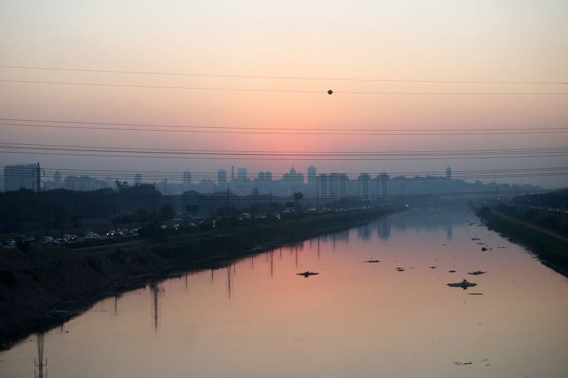

Speaking of that river in San Paulo, I was surprised how polluted it was:
July 2015 (Sony NEX-3N)

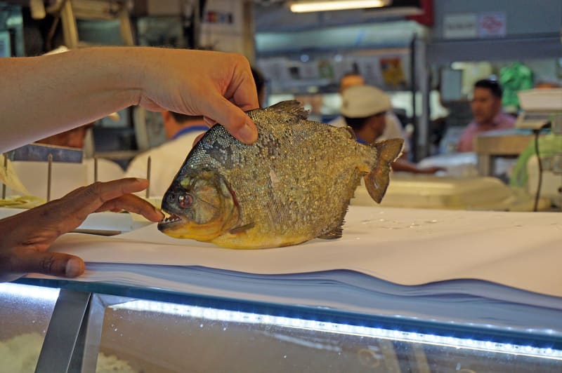

Where you can buy anything, including Piranha:
