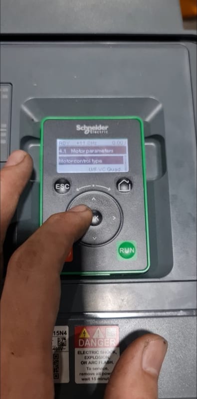

I wonder if my setting of Variable speed drive need to be fined tune for Constant torque application.
Application: 10 HZ of 15 KW 4 Pole 50 Hz
Pump: Plunger triplex at 20 LPM
Pressure: 50 Bar achieved by regulating the throttle valve with gate valve
VFD; ATV 610D
Setting : only set for 25 KW parameter
From manufacturing the following is the
Estimate Power at rated 300 RPM 20 Hz is 3.6 GPM 50 bar is 2 Hp.
However running in my setup of new motor 15 KW connecting in Delta 415 V.
10 Hz, 25 Bar is already close to locked rotor current of 36 Amp wbich shown thr motor slowed down and stopped.
I pressumed the VFD setting ia not configured to Constant torque load where V/ Hz ratio is low.at 10 Hz voltage is aeound 40+ Volt. This reduced the torque which increased the current.
the V/Hz ratio is too low, then the motor torque availability may not meet what is required and
the motor may experience a pull out condition. When pullout occurs, the motor will operate at high slip and potentially operate in the breakdown torque region, where the VFD will see high current and then

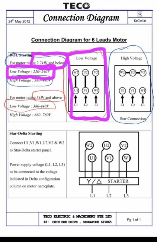

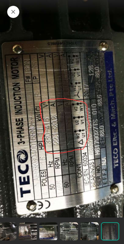

Just so you know, on a dual voltage 415/240V motor, Delta connections are for the LOW voltage, the higher voltage would be Star. So if you have the motor connected in Delta and are programming the VFD for applying 415V at 50Hz, you will be saturating the windings and causing … high current!
Hi Jraef,
The recomennedation for 15 KW from manufacturer is Delta connection.
I also tried star,It has low current when i increases the mechanical load for rated application such as pump pressure, result motor stalled unable to drivs the pump at low pressure.
From this 3 KW above shall be connected in delta.

By changing the U/F setting of VFD to 100%, i am able to drive the pump at 50 Bar. Before the setting of UF eas at 30%.
Motor stalled when i loaded the pump to 25Bar.

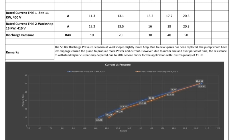

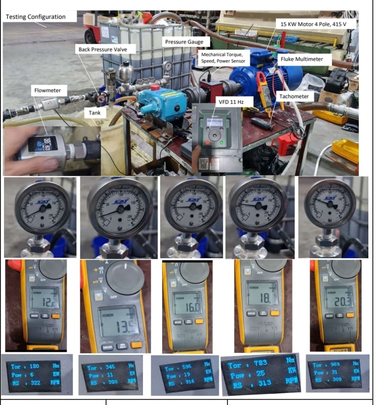

My objective of this workshop test using 15 KW motor to prove that the old motor of 11 KW at 11 Hz which has been run for last 4 years without any issue until recently has been run with undersized power.
The odd things why before pump maintanance of spares changed the exiating 11 KW motor has no issue running at 11 Hz at 50 Bar ?
I would need to investigate in my workshop with this 15 KW run at 5 different load test conditions. It proves that the VFD could provide torque boost except for 11 KW motor full load has exceeded its FLA.
However,The torque sensor shows much greater torque value vs motor rated torque despite the amperes is within 15 KW full load current.
Maybe you all can enlighten me why despite such high torque demand, the motor can still drive it .
I observed that using Quad which is variable torque has much lower current at maximum load of the pump of 50 Bar at 11 Hz using 15 KW workshop test.

I changed the VFD setting U/F setting of VFD to 100%, i am able to drive the pump at 50 Bar.
Before the setting of U/F wass at 30%, Motor stalled when i loaded the pump to 25Bar.
But from torque sensor, it showed high Torque, but the motor current of 15 KW in my workshop was srill within its rated.
