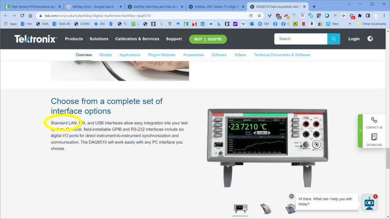

Hello, I am looking for an analog input card or device that measures resistance, and interfaces with an Allen-Bradley PLC, preferably using Ethernet/IP. The measurement repetition rate should be less than 500ms or so, ideally less than 100ms. Resistance range is about 50-500Ω. We need 48 channels, so high density is valued. 12-bit resolution should be sufficient. What options are out there?
I have explored the brands Wago, Allen-Bradley, Advantech, B&R, and Beckhoff so far, but each of their solutions has various drawbacks.
I am open to using a voltage input card, but the full scale range would need to be around 200mV, not the standard 10V. And plus going that route would require pull-up resistors, complicating the panel wiring.
Thanks for the quick response IR. Looks like that Keithley solution is close, but it looks like it does not offer any industrial comms protocols such as Ethernet/IP, Profinet, Modbus/TCP, etc. This needs to interface directly with an Allen-Bradley PLC.
The webpage I linked says "Standard LAN"
