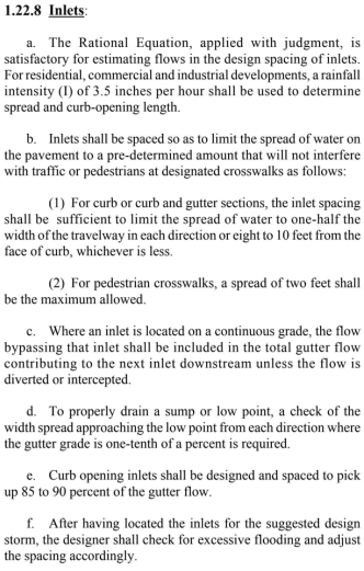

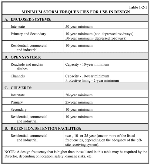

Our local, regional and state criteria use a 10-Year return period for onsite drainage. I recommend you check with your governing agency. A great resource is the FHWA HEC22 Manual.
Here is one localities criteria.
[URL unfurl="true" said:
https://www.nnva.gov/684/Design-Criteria-Manual[/URL]]
. These criteria are based on
https://hdsc.nws.noaa.gov/hdsc/pfds/pfds_map_cont.html[/URL]]NOAA Atlas 14 Point Precipitation Frequency Estimates
Does your urbanized area have some criteria? The criteria may define what constitutes undesirable roadway flooding
Thank you gbam and FacEngr for the valuable information
The project's jurisdiction has very similar storm event design criteria as in FacEngr's post.
