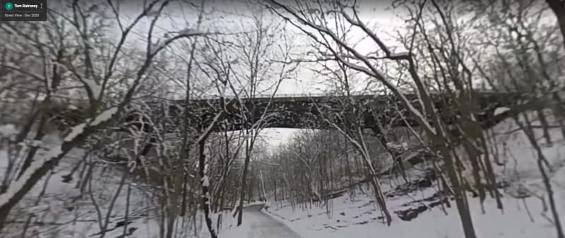

Hard to see on Google, but it looks like a rigid K-frame.

I grew up 5 or six miles from that bridge. I remember its predecessor, but I had to search to refresh my memory of the current structure, which agrees with the picture above.
Google street view shows it posted with a 26 ton weight limit.

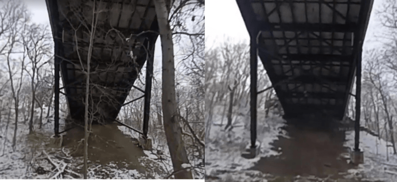

Pic from December 2018 from Twitter @gpk320

It looks like they tried a band aid fix for that. But not a large enough band aid if that member goes into compression.
With a few inches of snow and the bus, that was well over the posted weight limit. Interesting to see how this might affect public transportation policy if our vehicles are too large for our aging infrastructure.
It looks like the east bent is missing the lower cross bracing compared to the west end. It's a bit blurry from the google street view but its still clearly missing. The resolution is too poor to see if the cables are still there. The images are from 2020, 2 years after the pic of the cables was posted.
