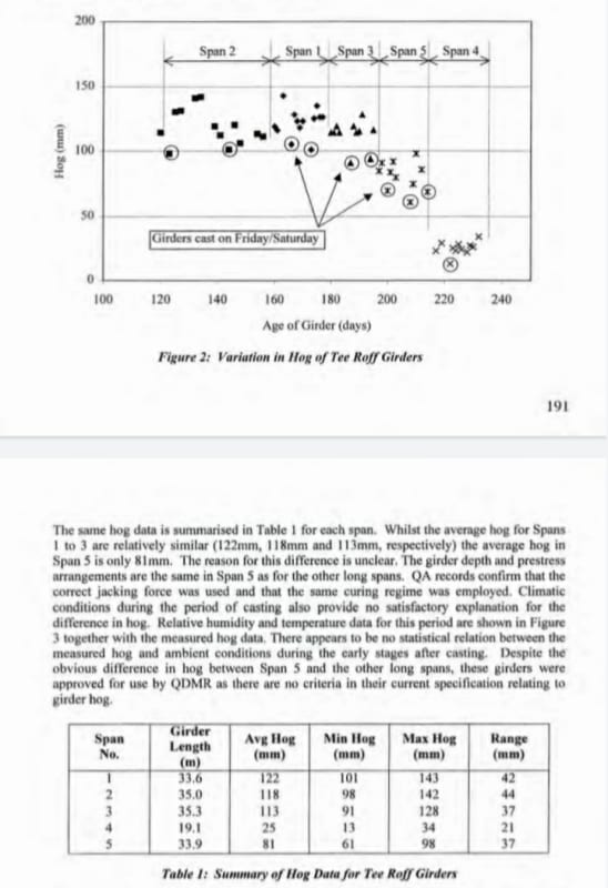

I have done a fair bit of work in this area, and reached similar conclusions; see "Practical methods for the analysis of differential strain effects" attached.
The "Super-T" bridge girders used in Australia are particularly susceptible to differential strain effects, because they have wide thin top flanges and compact bottom flanges, nonetheless these effects can cause significant variation in behaviour in any pretensioned girder, and need to be considered if there is a strict contract requirement for no downward camber.

Rod - certainly the actual criterion needs to be defined, but I think the important point is that there is no simple method that will provide a reliable estimate of actual deflections.

Agreed. There don't seem to be any simple ways to get good deflection estimates, although from what I understand the complex methods aren't much better. As far as I have understood, the only thing that results in any decent consistency, is specifying a long time to release of the strands/transfer to the concrete, but prestressers really don't like doing that.
