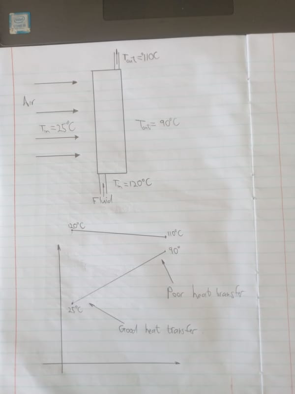

I'm designing fin-tube heat exchanger (water-air). I have all the calculations needed, heat exchanger is manufactured & tested and works great, but as a curious person I'm still wondering about some theoretical aspects. I currently don't have any collegues in mechanical department, so I really appreciate any discussion on the subject. I'm still very fresh engineer, so correct me if I'm wrong anywhere along the way.
To visualize the case a little better, here is a simplified drawing of heat exchanger:
Knowing the coolant flow for the cooling loop and the size of the Inlet/Outlet coolant connections, we can find the velocity of fluid using: Q = V/t = A*v = (πd2v)/4

You know the total flow and the total ID area of the tubes so you can figure out the average velocity.
Unless the total ID area of the tubes is less than your inlet you will have significant variation in flow from one tube to the next.
While the flow velocity does impact heat transfer there isn't a step function in the range of 1.5 m/s - 4 m/s, it is fairly proportional.
Some materials can tolerate 30 m/s (most SS), others begin to have erosion issues above 2 m/s (Cu).
The fact that the inlet and outlet are offset from each other would contribute to the flow being evenly distributed between the fins. If the inlet and outlet were directly opposite each other then you would be more likely to have more flow through one side of the heat exchanger than the other.
Then you said something interesting that is a common misconception with heat exchangers. You said something about lower velocity causing improved heat transfer because the inlet and outlet temperature are more different. This is not an indication of heat transfer efficiency. If your outlet temperature is much lower or higher than your inlet temperature it could actually be an indication of poor heat transfer. It means that the delta T between the heating fluid and cooling fluid closer to outlet is becoming less and less and that means that heat transfer is becoming worse the closer your getting to the outlet. It means that the flowrate of the fluid that you are heating or cooling is too low.
This is a good example of where an increase of the air flowrate would improve the heat transfer. If you increase the air flowrate to a point where the outlet air temperature is about 40 degrees celsius you would improve the overall heat transfer by a lot. You could probably drop your inlet temperature of the fluid into the heat exchanger and by extension the overall system temperature of whatever you are cooling. Obviously this is not always a good thing, but it is food for though nevertheless.

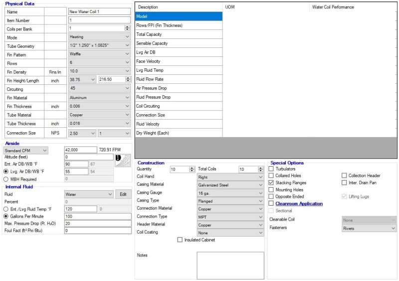

Vfresh, just to give you a little more to chew on - this is a section of the input screen for a coil selection software. It gives you an idea of some of the design variables that influence performance. If you can get your hands on selection software and a crash course in using it they can be somewhat illuminating to mess around with and try and understand why different input changes influence the performance (and you don't need to do the math yourself every time)
If you go deeper down the rabbit hole on these units be aware that everyone uses a lot of different terminology. For instance the coil snip is in "heating" even though the project is working to cool a process because of how this company arranges the terminology for their product, and the item is a "water coil" despite being rated and used for a wide array of fluids. Inlet/outlet, entering/leaving, heating/cooling, supply/return, etc can all flip depending on the framing of the conversation. The same product is called something different, sometimes incorrectly, by every customer, vendor, and colleague; Dry Cooler, Radiator, Fin-Fan Unit, Fluid Cooler, "Chiller", Air Cooled Heat Exchanger, Heat Exchanger, Water Coil, Aerial Cooler, I'm probably forgetting 10 more I've heard.
