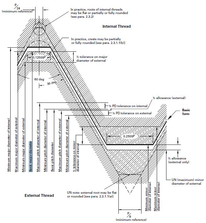

Hello Engineers,
Can you help me find min and max tolerance for major diameter of 2 11/16 -12 threads? It’s not a standard thread size. I couldn’t find it online.

Refer ASME B1.1-Para 5.8. Since your thread size is special one, I think, you can use ASME B1.1 formula to calculate the tolerance.

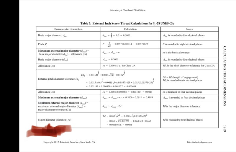

Here is that formula:
P=1/12=0.083
Major diameter external tolerance: 0.06 x(0.083x0.083)^1/3
=0.0114”
So this tolerance is plus what and minus what?

AMSE B1.1 said:
5.7 Disposition of Allowance and Tolerance
The disposition of allowance, tolerance, and crest clearances for the various thread classes is shown in Figures 5 through 8 and 10 and 11.

There is a class 4 thread where there is a plus tolerance. It can be anything you like if you specify "MODIFIED" and state the modification. Otherwise thread Major diameter tolerances are 0 or negative.

As 3DDave suggested and looking at figures in ASME B1.1 the basic tolerance is +0 to -tolerance value. So basically the nominal size is tolerated to be decreased from nominal size towards decreased diameter. So +0.000/-0.002 is good if achievable, I think. But why do you want to use these values instead of following standard? Did you ensure that the mating internal threads will be having same tolerance?

Your thread size is not on the Macinery's Handbook's tables. The Unified National thread specification is described in sufficient detail that you can work out the tolerances.

Drawoh:
You are correct. After searching in Machinery’s handbook 29th edition, on page 1869, I found the above formula used to calculate tolerance of major diameter. So yes, it was there.
