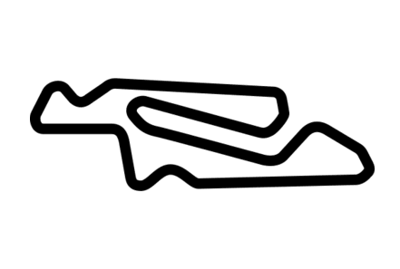

If my main objective is to get a car around a (asphalt)track the fastest, lets say this track 2.5 mi
should I be setting up for under neutral or over steer.. ie what is the norm in race car land for the fastest setup? Thanks again!
Az. Motorsports Park speeds can get ~200 mph. That means aero balance moves around quite a bit. It all depends on tires and driver skill. You have 4 wheels or 2 ? 4 wheels usually likes a tad of understeer to align the car's frequency response with the drivers. So, digital sound source, incredible amp, great ears and shit speakers means shit sound. They all have to be in "Q". Generally oversteer can be tolerated at "low" speed, as long as the steering gain is still high and the steering effort is light. At high speed, an understeering car can be nervous because of its lower damping coefficient.
Then there is the vernacular: What is "understeering" ? I imply that "understeering" from any level of driver means that the change in front vs. rear axle slip angle gradients is no longer constant, but is up (understeering) or down (oversteering).
Your question also needs clarification between qualifying (I own the line for a few laps), or racing (I have to share the line with a better or worse vehicle + driver combo). Podium for Finishers, not crashers.
