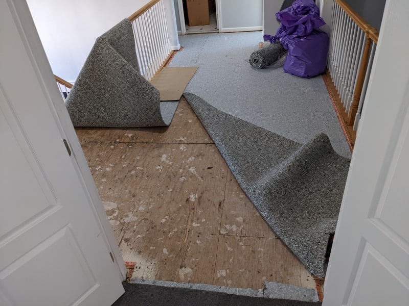

I'm a bridge engineer by profession, but I'm having a bit of an issue at my personal residence at the moment and I'm hoping to get a few questions answered.
We are having carpet replaced on our second floor, and in the process the installers are screwing down the 3/4" t&g ply subfloor to silence squeaks. For the most part, there weren't any squeaks to begin with, except in the landing/hallway area. I was able to get copies of the builders plans from my township (house was built in 1994), and in this one particular problem area the composite I-joists are 24" o-c. Everywhere else in the house the joists are 16" o-c. The joists in this area mostly only span about 8-10ft, with 1-2 spanning closer to 13ft. But obviously that's of little importance when it comes to subfloor strength.

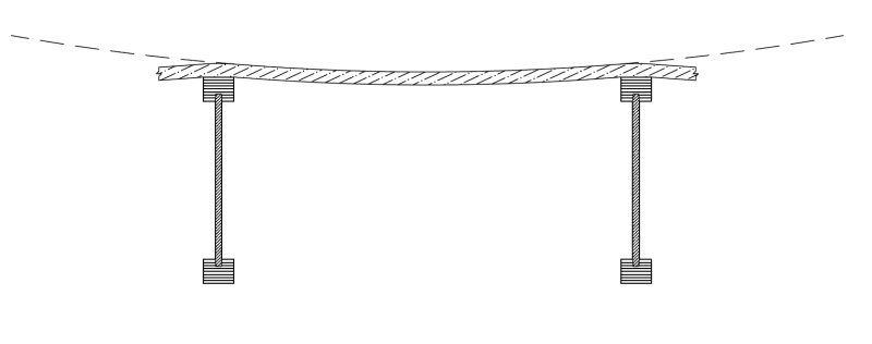

Jayrod, he is referring to the radius of curvature developed between the floor joists:
BigRy, first step is going to be to determine the nominal panel thickness that was used. I assume the panel meets PS2 quality standard (it's hard to find a structural panel anywhere that doesn't), and as such, the panels nominal thickness will be printed on one side of the panel (if the panels were installed oriented correctly, this should be on the bottom side of the panel). Keep in mind that nominal thickness differs from actual thickness. A manufacturer can make a panel however thick/thin they want, and still achieve the nominal panel thickness rating for PS2 performance and nail lateral/withdrawal performance, so a caliper measurement will not be sufficient to determine panel performance.
Once you get the nominal thickness, you can check against APA documentation that indicates the allowable loads and deflection performance based upon loading at various joist on center spacing.

Ok so i think the first order of business is simply to pull the nails in the problem areas to see if it has any impact on the squeaking whatsoever. If I happen to get lucky and that be the case, then maybe I can just leave it as is despite pretty significant deflections when I walk on it? Is there anything more than could be done to prevent squeaks from starting again? Reinforce the tongue & groove with a penetrating glue? Anything like a stiffening compound similar to a leveler that I could pour over the surface to really seal up and stiffen the entire subfloor diaphragm? I should note, the floor has gotten squeakier since we bought the house in September. I don't know if this is due to use or weather/humidity. We're in a suburb of Philly by the way. Previous homeowner who bought the house new was a small elderly Chinese lady who probably practically floated on the floor...
If nails aren't the culprit, then the next order or business would be to try to determine if adhesive was in fact used, because it sounds like I'd need to be a magician to properly replace sheathing that's glued to composite I-joists (I'm far from a magician). If they are glued and clearly still bonded, I won't attempt to replace the sheathing based on what you all are saying. I don't know where that leaves me though. I really REALLY do not want to tear out a bunch of sheetrock to access the underside. Maybe i could make that part of our kitchen remodel we will be doing in the next couple years (this area is adjacent to the kitchen).

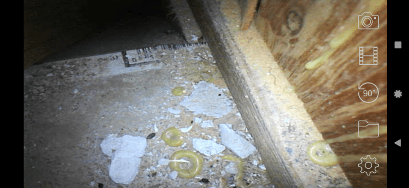

I tried looking around real quick with a light to see if I could find any locations where a bead of adhesive had ran over the edge/end of the flange, but I had no luck. I did however find a spot in 1 joist near the edge of my living room that has about a 1'-0" length of joist flange that is split off from the rest of the joist and bonded to the underside of the subfloor. So I'm guessing that means there is adhesive there. Looks like the subfloor bowed up a little in that location and took part of the flange with it. Not sure what to do about that now ugh. At least the joist is accessible.
Ok, so i got up there and tried to pull some nails. A got about a half dozen out in the worst area. The nails are ring shank, with one oddball smooth shank 16c nail. Most of the nails wouldn't budge. I was just bending them at the shank when trying to pry them out. So clearly they weren't loose at all. Didn't want to damage the sheathing anymore than i already was, so i didn't try to hard.

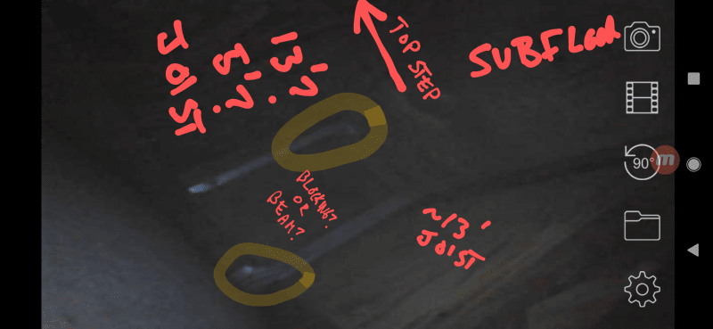

Instead of trying to pry up a corner or edge, i opted to try my bore scope first. There was a small spot near the railing post that i dropped into and was able to confirm the adhesive was used, because a ton had leaked down the side of one joist. I couldn't maneuver in this location, but I was able to slip it in a wide gap at the top stair and look into the first bay and at blocking near the railing post. I saw no missed nails and didn't see any significant differential movement on the video when i walked on it. The entire system seemed to deflect a lot though. And although the video is grainy, i think one of the joist hangers on the blocking was installed upside down. The framing in this area doesn't appear to match the plans, and i can see the end of a joist in a gap in the t&g above. This joist is supposed to span full length to the LVL. I'm trying to make sense of what they did here, but it seems like they got joists framing into joists. I wonder if there's any possible way to cut out like a 12"x12" section of subfloor in the middle of the bay just to get eyes on this. Thoughts?
Is it a head out that you are seeing? Maybe a joist was damaged and they installed a header to reframe? Is there an HVAC vent in that area that may have required a larger opening than the joist spacing, so a head out was used? Also, check and make sure it's actual subfloor adhesive you are seeing, and not the adhesive the joist manufacturer used to attach the joist web to the flanges. Subfloor adhesive is often a light tan color, but it's usually thick and tacky enough that I would not expect it to run down the side of the joist.

The adhesive i saw appears to be yellow in color, which i agree is unusual. What's odd though is that it is not only on the joist, it also leaked down onto the sheetrock for the 1st floor hallway ceiling, so whatever it is it was installed after the sheetrock was put up on the first floor. I wouldn't think there would be drywall going up before the framers are finished, but there's no evidence of any yellow glue on the top side to suggest that maybe something had leaked down from a spill or something. I really don't know what to make of it honestly. It's quite a lot of glue actually.
I've been thinking a lot about what i observed on my bore scope, and the more i think about it the more i think the framing plan is wrong. The framing plan has most of these joists at a relatively short span (about 8ft), but there are 3 joists spanning about 13ft. That extra 5ft is for the top of the stairs. It looks like the joist nearest the top stair is actually not a full length joist. It might be framing into a beam that then frames into the next joist over. The plans don't call out this beam member at all, but i can distinctly see that it's an identical 14" composite I-joist. If this is truly what's going on, then i wonder if there's too large of a concentrated load on the one 13ft joist that's taking all this weight. This is right where the loudest creaking is occurring, and the entire system was deflecting a decent amount under my weight when i was recording video on my bore scope (it wasn't just the subfloor).
